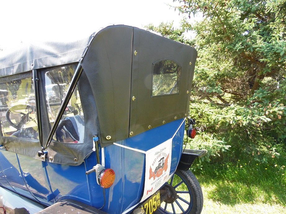

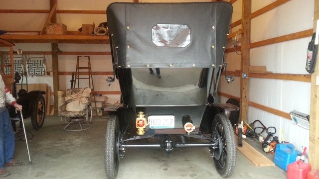

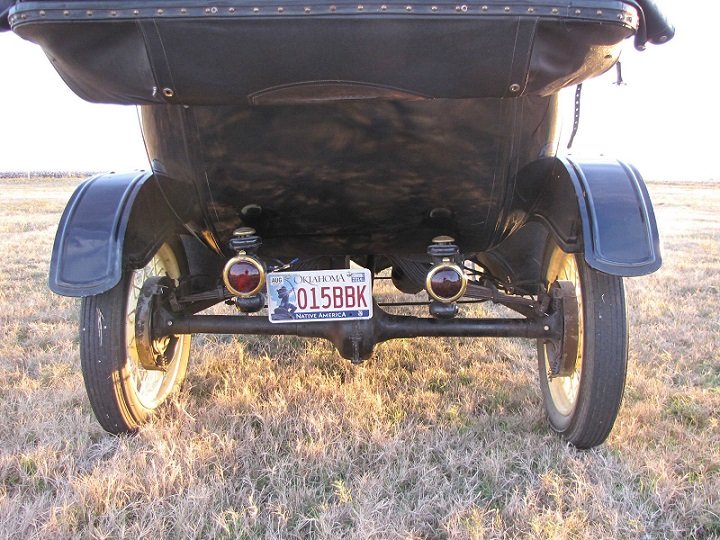

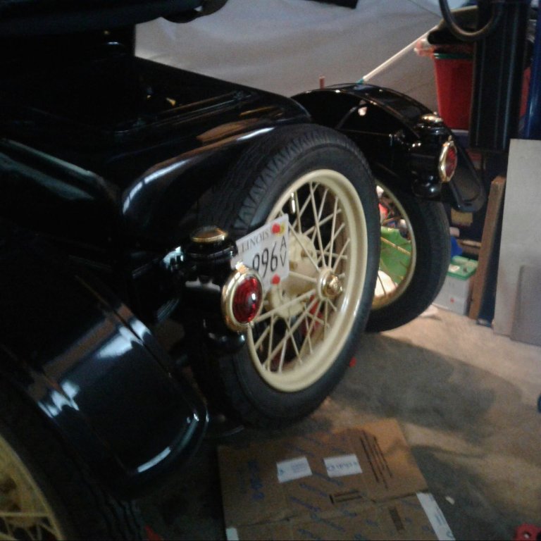

This is something I have struggled with myself. If the tail lights are too unobtrusive they somewhat defeat the purpose. I have done 3 iterations of tail lights myself, which I will share in a moment. For my 1915 roadster, I use electrified side lights as the front turn signals. While I have LED bulbs in the tail lights, I use regular filament bulbs in the front turn signals, so they don't hyper flash. The vendors sell a tail light bracket that attaches to the top saddle iron, which you can then use a standard electric Model T tail light. I like this solution best for a touring car, as it is very visible, and still "Model T-esque". I think it works less well on a roadster, as the roadster saddle arms are further forward on a roadster. Here is he vendor bracket on a roadster:
Here is a similar, owner built bracket on a touring car:
Here is my tail light journey (which is complicated since I carry a rear mounted spare on my 1915)( I also don't believe in making any additional mounting holes in any of the metal):
A little too obvious, but certainly visible:
Less obvious, and I decided that was a problem, in that the rear turn signals were only visible to vehicles directly behind me:
My current tail lights, are 1915 kerosene tail light and a side light with a red lens, on brackets I made up, which don't make holes in any metal:
In an additional response I will post photos of other tail lights that I have seen, in case those examples are helpful for the poster.

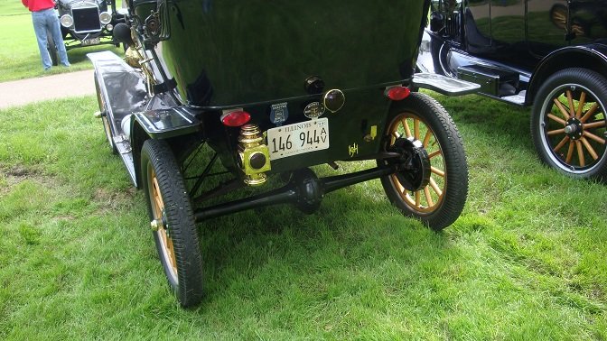

Re: Adding brake lights and turn signals on Brass Car
Post by WayneJ » Sat Apr 24, 2021 9:52 am
More tail light examples:

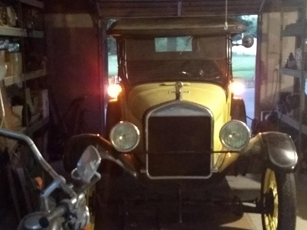

WayneJ
Posts: 542
Last Name: Jorgensen
Location: Batavia, IL
Post by WayneJ » Sat Apr 24, 2021 9:54 am
One more:
