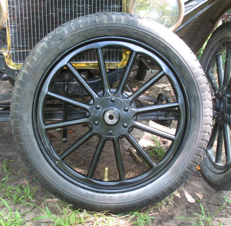

Well, you'll get a dozen answers, all of 'em noteworthy. For me, I use the same as on fenders...gloss black Concept. Very durable, nice finish. Some people prefer a more satiny look, I like to start out pretty glossy, 'cause the weather and road grit and grime make 'em less shiny over time anyway.

Tim is correct. This question can get as many answers as "What kind of oil?" For wheels I use gloss black Rustoleun. It's inexpensive, needs no primer, and is very durable. I think it looks OK too.
