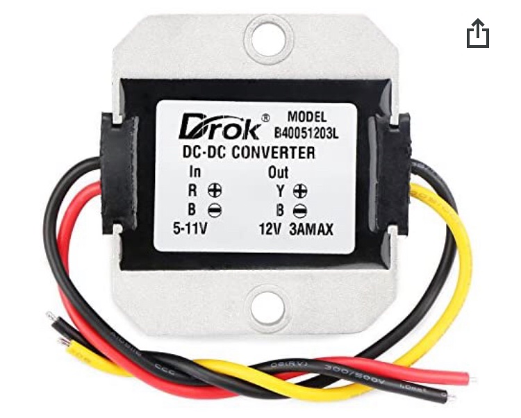

For what it’s worth -
Had one of these laying around and never used it on the T,
but thought I’d try to fire up one of these led conversion bulbs. 6v would not pass the start test, but these have no problem lighting them up.
Don’t know how much each lamp draws, but 3a might handle 2 if you must stay with a 6v system.
