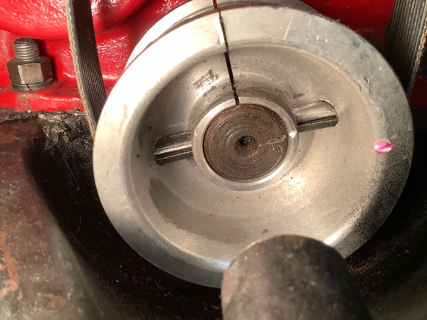

Dropacent
- Posts: 3384
- Last Name: Morsher
- Location: Norwalk Ohio
Re: Finding top dead center with Rajo B head
I always use this simple trick on my cars. I think Ted Ashman shared this originally. I put a small chisel mark ( Dremel cutoff would do the same) at top dead center. I also but a little match mark in the pulley ( Dan’s pulley , of course!). Makes it easy peasy to just reach down to find TDC at the 3 o’clock mark with your fingernail.
