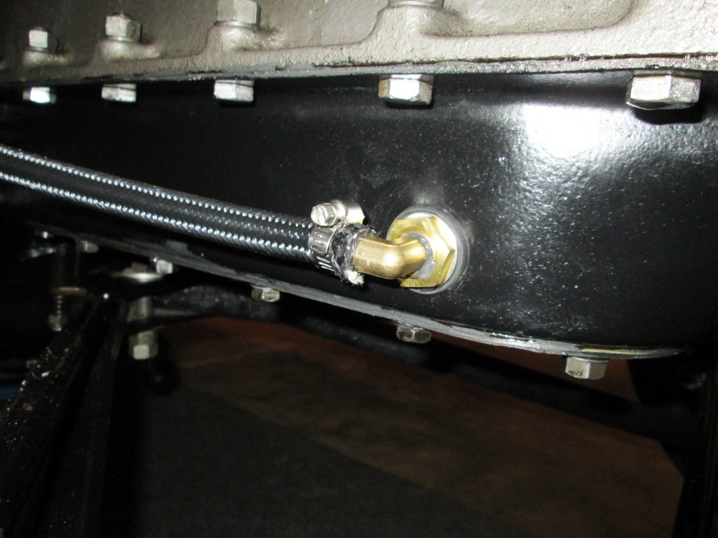

I plumb mine through the pan - makes it much easier to remove the lower cover for maintenance !
