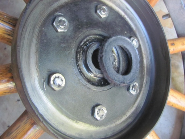

A larger donut of felt is also placed into the recess of the brake drum hub, grease it too to compress. Work the grease into the felt, all felt washers need to done this way, don't fit them dry.
This wheel hub felt rides against the steel dust cap to prevent scaring of the cap.
