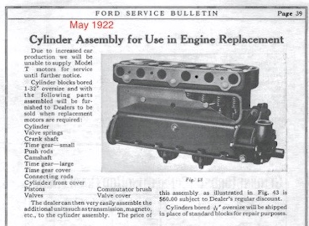

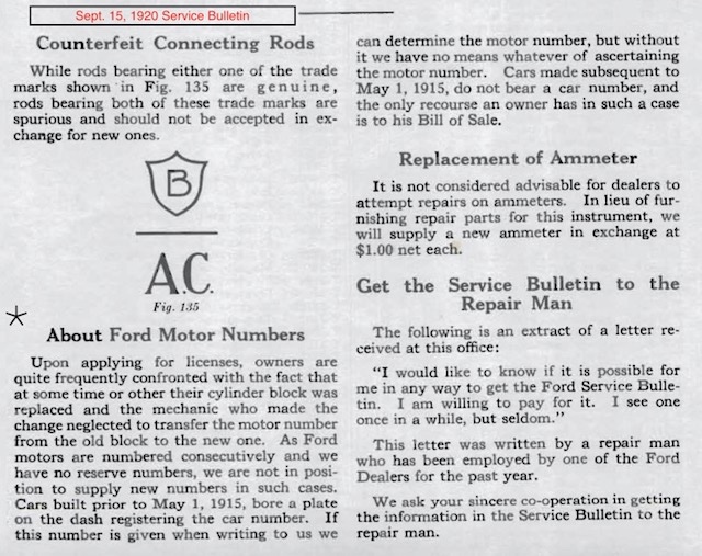

This bulletin was earlier, when Ford was jamming, sales soaring, and the factory couldn't supply finished engines for replacements, so Ford offered to dealers an 'assembly', the cylinder block was un-numbered, but was stuffed with parts to be a 'complete short block' rather than a bare block. Don't know how may were sold this way, or when the company stopped offering these.
Bulletin again confirming that only 'assembled complete engines ' got serial numbers, and bare cylinder block had none.
