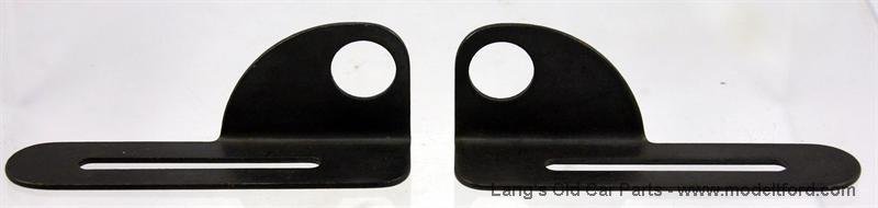

This one fits the 1921-1927 spring clip. You could make something similar to use the 1920 and earlier spring clip, but it would need to have a jog up or down to miss the crank handle.

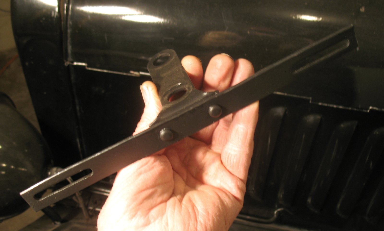

The 19 uses a two piece mount. Part number 3664e in Langs catalogue.

Here is the one Lang's sells[.

The pair of license plate mounting brackets sold by the vendors are worthless.
They need to have dog-legs so the crank clears the license plate.
See the three photos that I posted in this thread - this is what is needed but good luck finding a pair.
