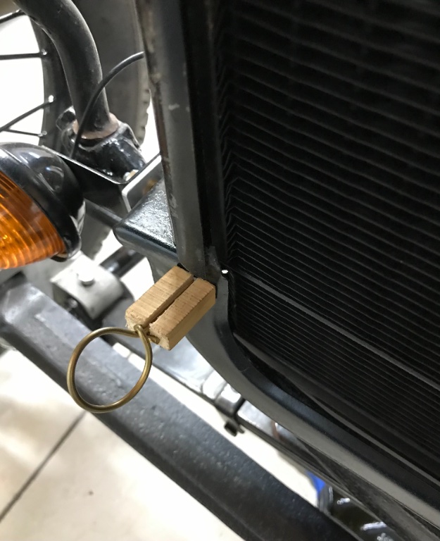

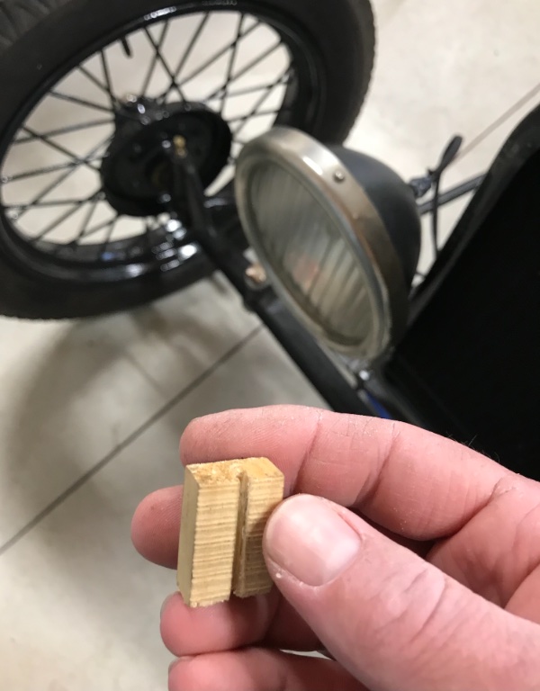

I also agree that they are all a little different. Each of our 3 T’s has their own different routine when starting.
When it’s colder out my speedster likes to have a little more choke once it starts. I made this little wood spacer to hold the choke on while I run around and pull the timing lever down and switch it over to mag.
