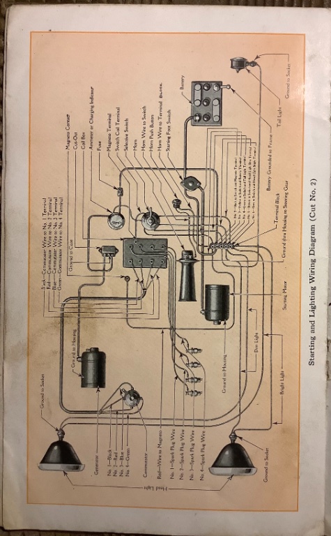

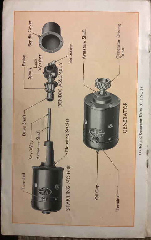

F A Starter System booklet
Post by Dropacent » Mon May 17, 2021 6:59 pm

Post by OilyBill » Mon May 17, 2021 11:44 pm
Thanks very much! Very interesting!
I also note that these early units had a data plate on both the starter and the generator.
I have never seen one of these early units, or if I have, I did not know what it was. I will be keeping my eyes peeled now! It would be cool to have a 1919 Ford with this original starter and generator on it.
I think the rarity must be accounted for, because of the advice that if there is trouble with either unit, they should be removed and sent back to the factory. I'm sure they were replaced with the later style units that everyone has, so the number of very early starters and generators that are left out in the general population must be VERY small. Probably the best possibility would be a 1919 car that was parked within 5 years or so of being purchased, before either the starter or generator had the chance to develop a problem and be subject to replacement.
I would be curious if any members have a set of this early electrical equipment on their vehicle?.
Thanks again for posting this! Complete information posted on a very interesting and rare equipment style!
Ron Patterson
Re: Early Starters
Post by Ron Patterson » Tue May 18, 2021 8:07 am
The FA System pamphlet depicts several interesting things.
Both the starter and generator have Liberty Electric data plates.
The cutout shown in the wiring diagram would have been mounted on the firewall with a ground wire.
The generator does not as yet have a oil slinger.
The charge indicator in the wiring diagram is shown as an ammeter OR indicator.
There is another non Ford book at the McCalley Library showing the other unique Liberty Electric internal manufacturing features.
