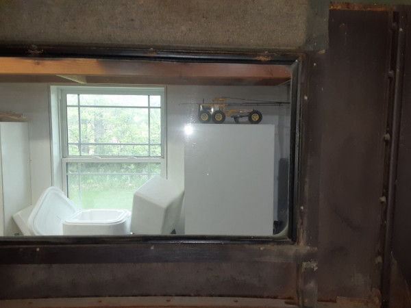

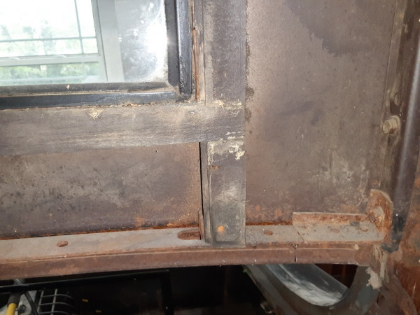

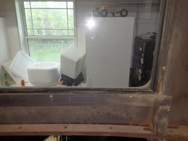

How to Remove Glass from Rear/Quarter Panel Windows
I am in the process of removing the glass from the windows in my 1927 coupe. The photos show the windows. I have removed the hardened rubber on the inside of the rear window, but I haven't tried to "push" the glass out. I would appreciate any comments/suggestions on how to proceed.
				BLB27
- Posts: 892
- First Name: Bruce
- Last Name: Brakke
- Location: Ames, Iowa
Re: How to Remove Glass from Rear/Quarter Panel Windows
I got the glass out of the three windows. Chipped the hardened rubber out on the inside and carefully pushed each out.
