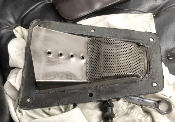

I see on the picture of the Ford Faithful Oiler that there is a special drain pan/filter that is part of the kit. I recently bought a T with an original Ford Faithful oiler. On removing the transmission door to see what things looked like inside I found that someone had ditched the original pan which looks like it is designed to feed the oil to the oil supply fitting with the standard aftermarket screen we all fit these days. Whoever installed it used the old fashioned hardening Permatex so its going to have to be chiseled off the door. Fun, fun, fun!
Will the modern filter feed oil to the line OK? Is just the Ford Faithful pan/filter available without buying the whole kit?

Post by speedytinc » Tue May 18, 2021 4:57 pm
You might put 3 of those large magnets to slow the flow to divert the excess into the faithful pipe. Or some other method to divert much of the oil from the screen.
Then look @ the flow of oil.

I have an extra pan. I am sending you a PM.
