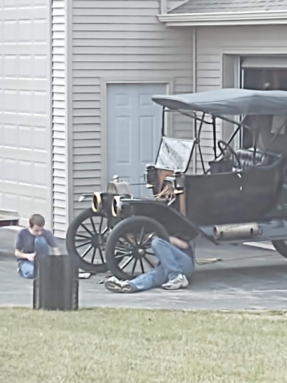

Thanks for the advice so far. Just so I understand before tearing into this, once I remove the hinge and separate the 2 halves, there will be a spring that may need replacement and some dimples that may need to be built up correct? Is there a source for the spring, or will I need to get creative. Any help is appreciated! I added a photo just for kicks. This is me and my boy removing the radiator to resolder the petcock.
