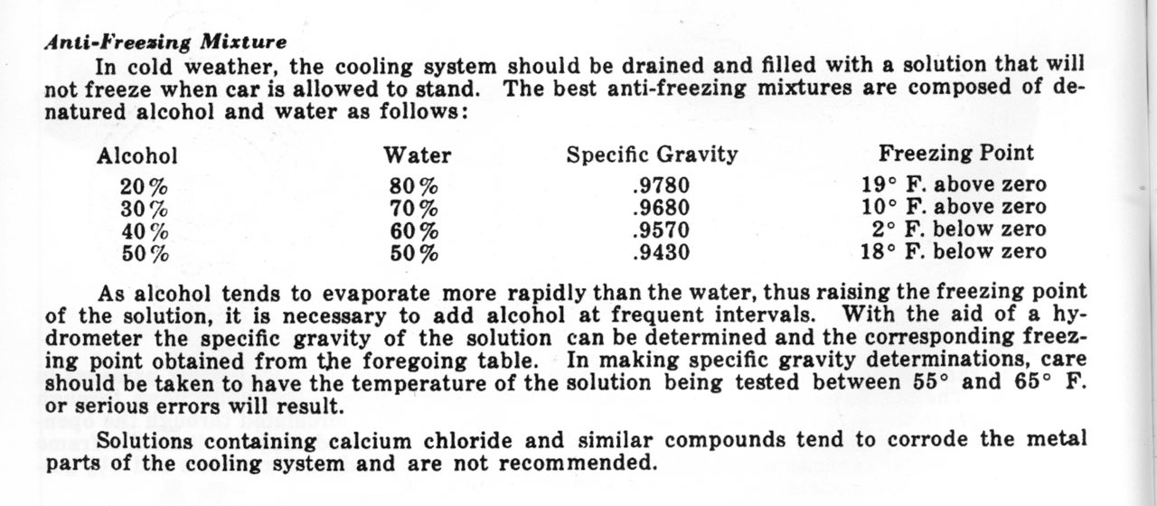

In the bygone days they would use kerosene. I bought an old engine once and it smelt like kerosene and had kerosene residue in side, it never froze.

altair wrote:
Fri Mar 15, 2019 12:41 pm
Wood alcohol was widely used also.

Do you know what proof the wood alcohol was?

Here you go Tom.

Tom Hicks wrote:
Fri Mar 15, 2019 1:11 pm
[/quote]
[/quote]
I want to say 180 proof ? 90% alcohol before diluted ...IIRC
