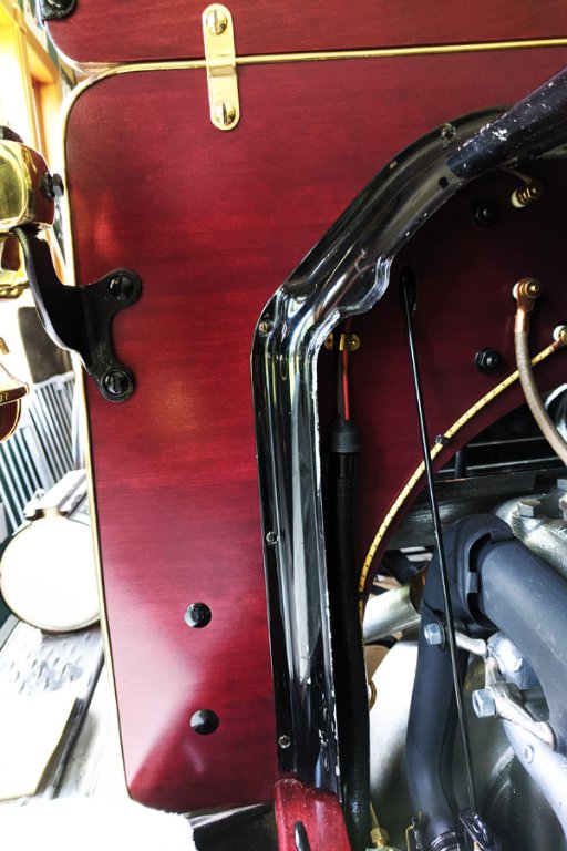

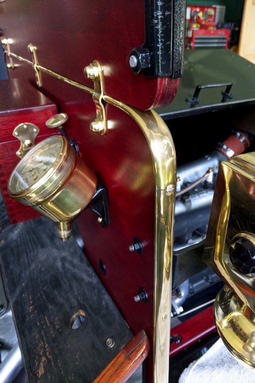

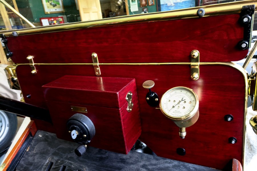

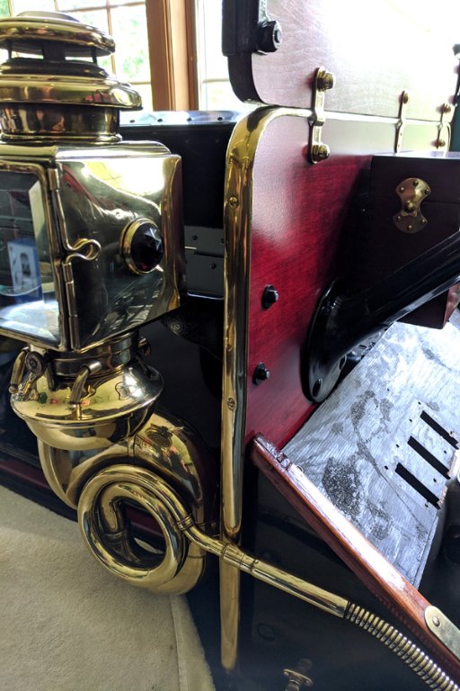

Re: 1911 dash shield installation
Promised pix. This car was first restored in the 50s from an original car by an HCCA chapter president. I have revised some details based on current research, but have tried to keep the car as it was excepting for safety, hidden functional updates, and improved restoration methods. The photos show a work in progress. I did not know that the dash edge was originally rounded before the trim was applied at Ford. Would the end result appear significantly different if I had rounded it? Cheers, Bill
