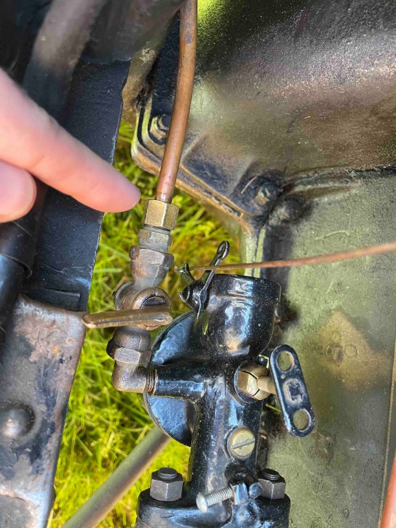

The cut-off valve you refer to - is that the one on the sediment bulb under the gas tank? Or, is it a shut-off valve mounted on the carb fuel line itself. If you are unscrewing the carb needle valve you may be over-richening the fuel mixture. What year is the car? Some photos of the carb might be helplful. I'm sure others will chime in but it sounds like you could have a fuel issue and it might be simple to solve if we had a bit more info. If it starts, then runs a bit and stalls, you're not too far from running and enjoying it.

Re: Help with a "new" T in Prince William, VA
Thank you Terry. Its the cut off valve at the carb fuel line. (finger pointing to it in the pic)

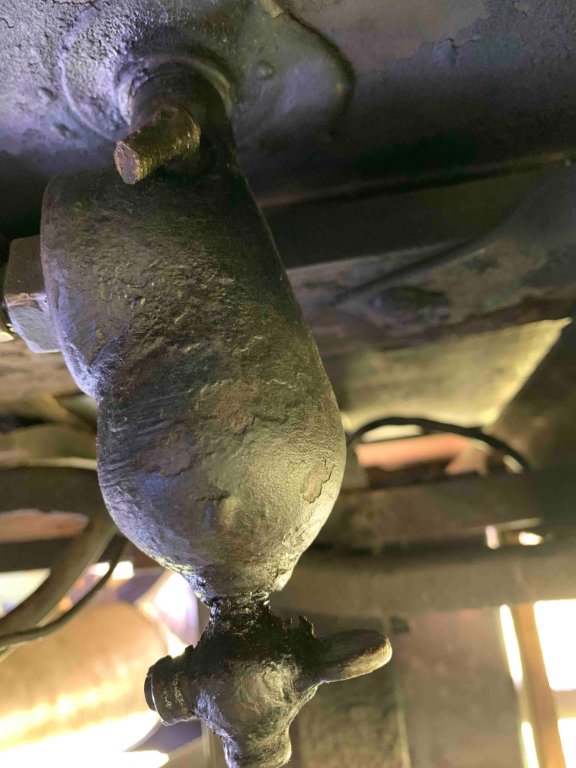

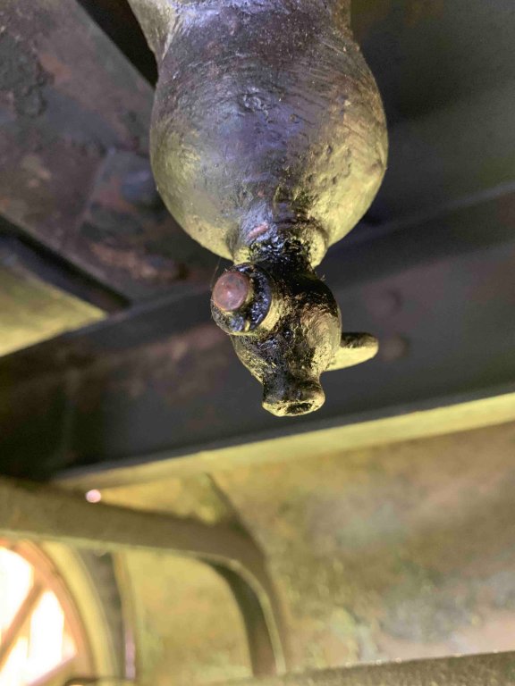

After reading some more i closed the carb needle and opened it a full turn. I have a 1924 Tudor with a Kingston carburetor. I tried to open the sediment valve under the gas tank (picture below) but wasn't able to. Need to figure that out too. It also looks like the shutoff valve arm at the top of the sediment bulb is broken? seems like just a nub.

- Posts: 6730
sediment bowl valve handle is broken off in mostly closed position
once car is running, you will want to repair/replace it as you will never achieve proper fuel flow for prolonged hill climbing or any sustained speed.

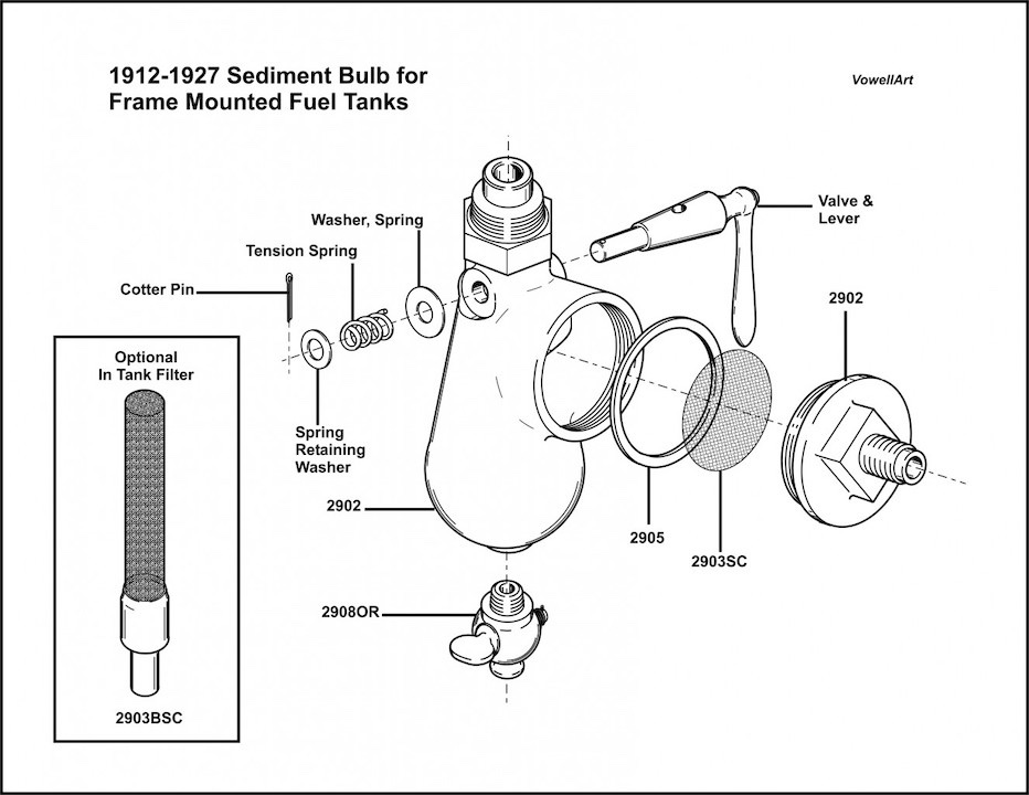

Mopar_man

Eli,
This is what it should look like. Take a look at the MTFCA Main WEB page under the Research TAB. Lot's of good information there.
If you buy a new one ask if it has EZ Turn Lube on it. I think Lang's uses it. If they say no let me know I'm down in Fredericksburg and I let you have some. A tube of it is expensive and you don't need much.

You are all awesome! That picture really helps see what it should look like and what I’m missing. The million dollar question now is how to get the gas out before replacing the bulb. I’m thinking open the line just before the carb and let it drain from there. May be slow since the sediment bulb valve is stuck halfway.
- Posts: 5170
You can GENTLY tap the spring side of the valve handle & turn the stub to down. That will restore full fuel flow, so you can run it untill you get a new sediment bowl. You gotta be chomping @ the bit to run it, I would be. Running out of gas in 20 minuets is from that fuel valve. Lets not forget to replace that copper fuel line & compression fitting with a steel line.
Under the sediment bowl is a drain petcock. May need a little tap to open also.
- Posts: 4638
Unscrew the pet cock on the bottom of the sediment bulb or you can unscrew the gas line at the carburetor. When and if you decide to remove the sediment bulb it may be pretty tight
so be sure to use the correct size wrench on it.
If you do decide to unscrew the pet cock on the bottom the gas may not seem to run out so get a wire and stick up in it. That usually does the trick!

ecory0
Topic author - Posts: 90
- Joined: Mon May 03, 2021 7:55 pm
- First Name: Eli
- Last Name: Cory
- Location: Bristow, VA
Got it off!!
