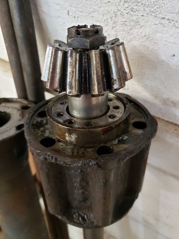

Embarking upon a rear axle assembly rebuild and this pinion gear is on here tight enough to give the cheapo harbor freight puller fits. Not wanting to ruin anything and being ready to man up for the right tool for the job, what gear puller would you recommend for this particular application? Thank you in advance for your suggestions.

Loosen the nut a bit and grab a large brass drift and a hand sledge & give the back of the gear a couple good whacks with OR a large brass hammer (2 lb.) works good !
