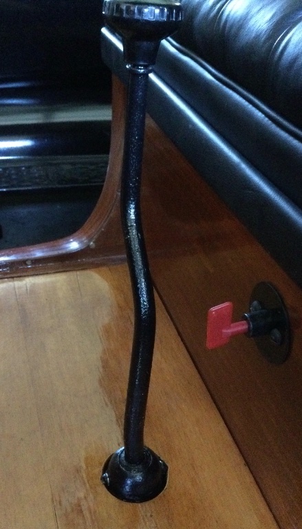

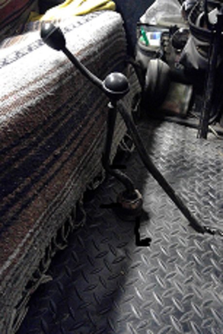

This is a cast iron warford that was always in my way. I heated the solid rod with the top bend first and then the lower bend about two inches to the right. It is still full height but easy to get in and out and not in my way. Frank
