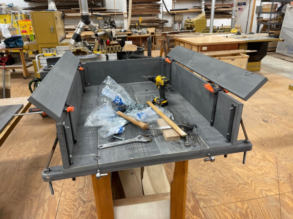

That is very nice looking wood. My opinion on this is cedar is very weather resistant but too soft to hold screws and will split easily. Mortis and tenon joints are very important in the construction as well as fastener placement in these joints. As I built mine using an original cab as a pattern, I noticed these joints were very tight and used one fasterner ( screw ) in the center of the joint. I think the reason was so as the frame and body flex these joints could pivot on the screw and not split the wood.
The modern way is to glue the joints. This is fine for a piece of funiture that gets little abuse. These bodies are bounced and flexed hundreds of times on each drive. I am still amazed that the doors on my truck are as tight as the day I put it together. The 1st time I drove it from the shop out into my pasture for a photo, I thought it was falling apart as I drove into the field. It popped and cracked everywhere. It was just breaking the paint at the joints. I used Poplar which is what my original was made of. Poplar is a hardwood that will hold paint very well and has a fine grain. It is what was used for wood siding on houses in the late 19th and early 20th century in my area.

I used Ash for the main runners under the bed. Very strong and light weight.
Dean, that would be another level of cool to cut and mill your own trees and build a body.

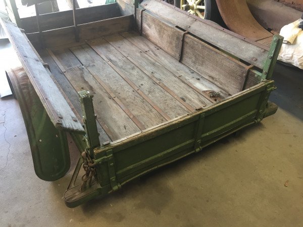

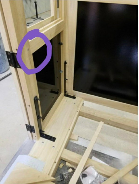

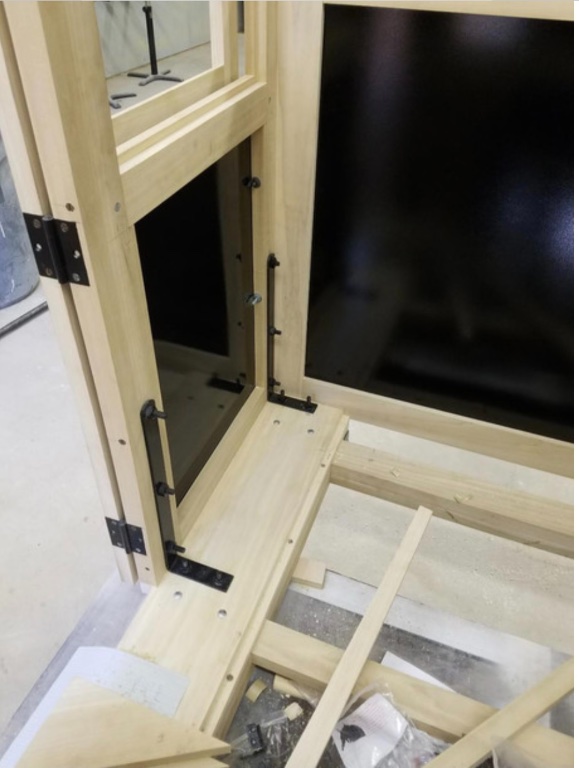

I am here, thanks for starting this thread Tim. I am trying to get my roadster pickup running. Then gathering parts to start on a wood body. I will try and document as much as I can. I got the bug when we drove up to Maine to pick up my Speedster body from Dave Currier last year. He impressed me with his stable of wood bodies and his picture book of all his past sales. I don't know how accurate his bodies are, but he builds them light, and they look good. I only had a couple hours to talk to him. But this sparked my interest in these bodies. I am also a military geek, and was hankering to build a M1917 ambulance. Did MP make any military bodies? I would speculate they would be peacetime contracts, as WWI was over.

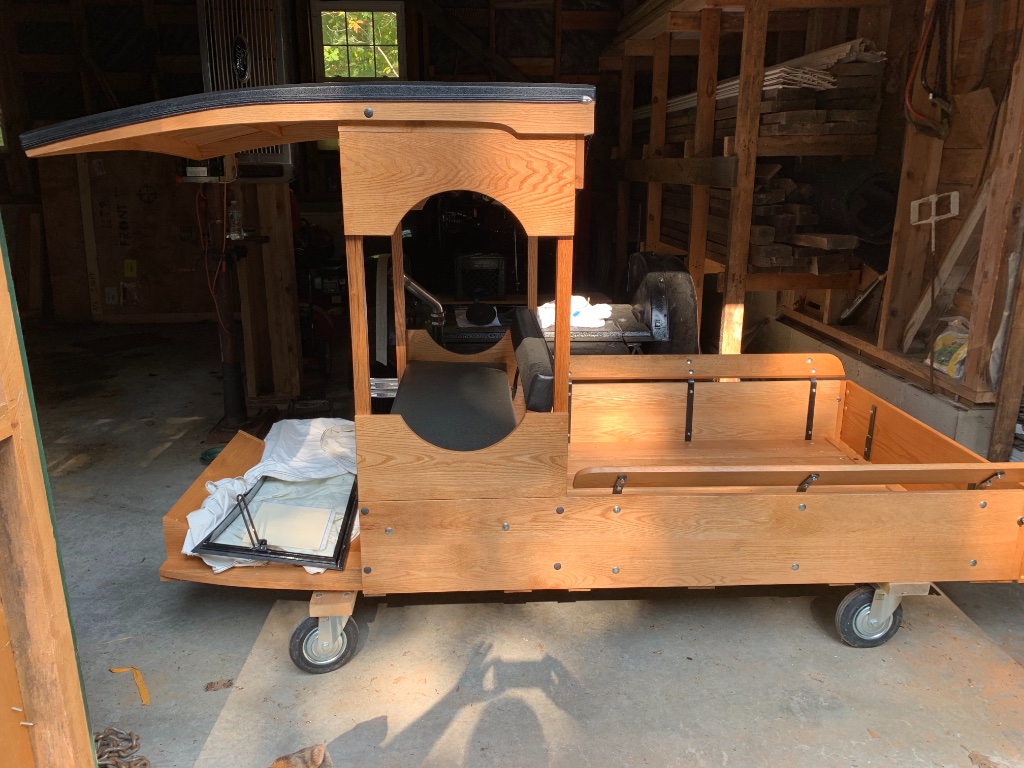

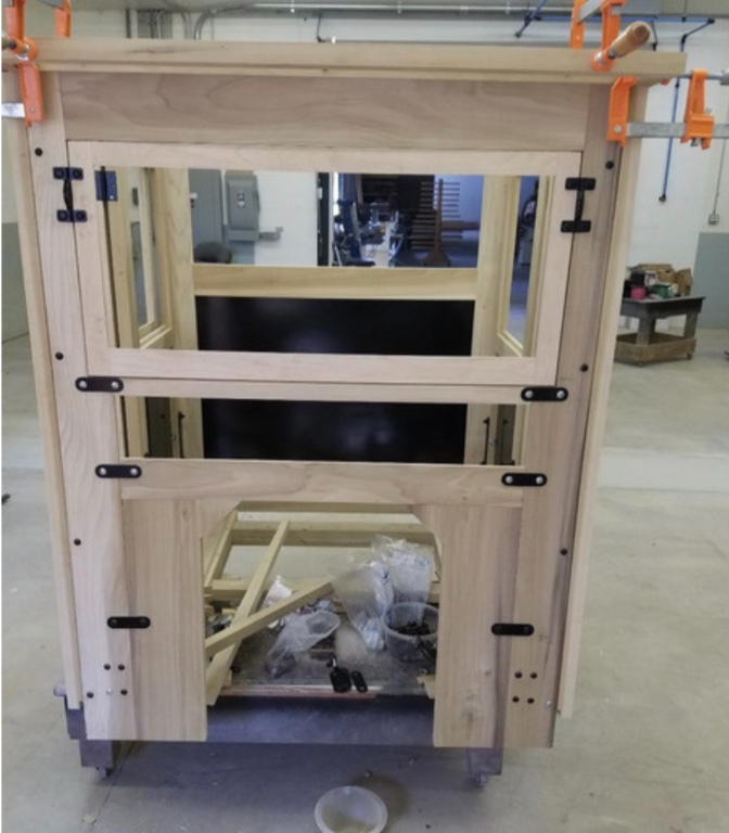

A few shots of what Dave was working on, again I don’t know what his bodies are a copy of

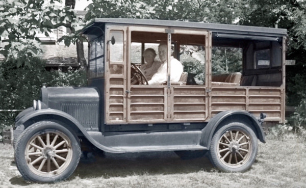

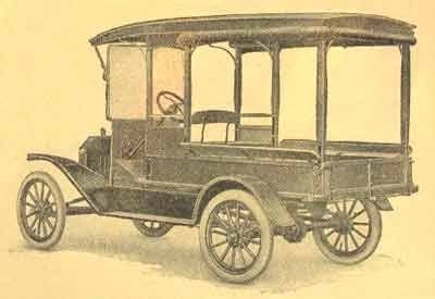

I have a set of plans somewhere that resemble this last body. I cannot for the life of me PUT MY HANDS on them. LOL
William L Vanderburg
1922 Center Door Sedan

I'm in the basement going through 30 years of collecting odds and ends. And this one item, I know I have. Somewhere. There was an article included with the plans of a guy who replicated a Coca Cola truck
I even have two pictures of the truck the plans were built for.

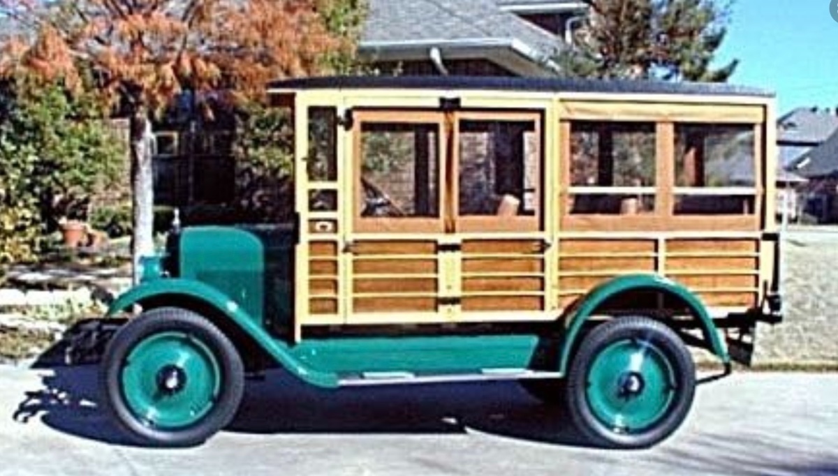

Post by Will_Vanderburg » Sun Jun 06, 2021 3:36 pm

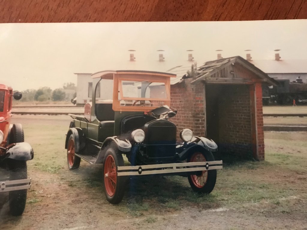

Here's a pic of the truck I have the plans for. This was taken over 25 years ago.

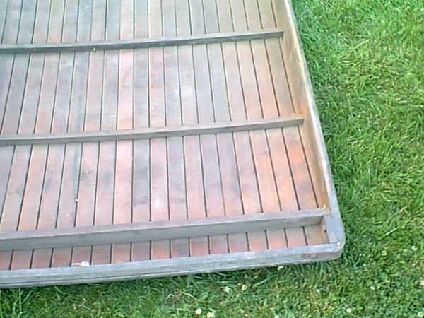

Dallas has all the right stuff on wood. I’d add that I’ve had 4 originals now. Still have two. From my observations, the truck cabs were painted and before that the finished panels were run though a big sanding machine. A lot of cross gain sanding happened before they painted them. I restored one wood cab back to original finish and think that’s enough for anyone’s lifetime. Never again, but it wouldn’t be hard to make a new one and then varnish.
Wood choice, I’ve seen maple and ash on the lower sill work, southern yellow pine floors. I’ve never seen anything but yellow pine floors, but that doesn’t mean they didn’t use maple, or similar. So perhaps they always “imported” the pine. On the varnished bodies like the station wagons ; Ash construction with birch or maple plywood panels. I’ve seen 3 ply and also 5 ply. I can share the thickness of the originals and if needed , a neat trick to make them up out of modern material.

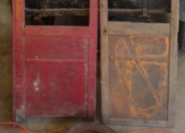

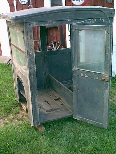

The woodwork itself. The truck cabs have thin metal panels inserted. They have a stiffening rib on them. I’ll post a picture. They used a pretty thin saw blade to make the groove. I have an old panel here somewhere, when I find it I’ll share the metal thickness.
Dropacent
Posts: 3384
Last Name: Morsher
Location: Norwalk Ohio
Re: Martin-Parry body thread

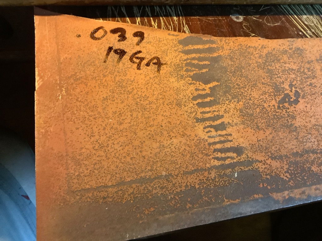

Post by Dropacent » Sun Jun 06, 2021 6:11 pm

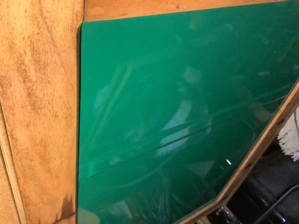

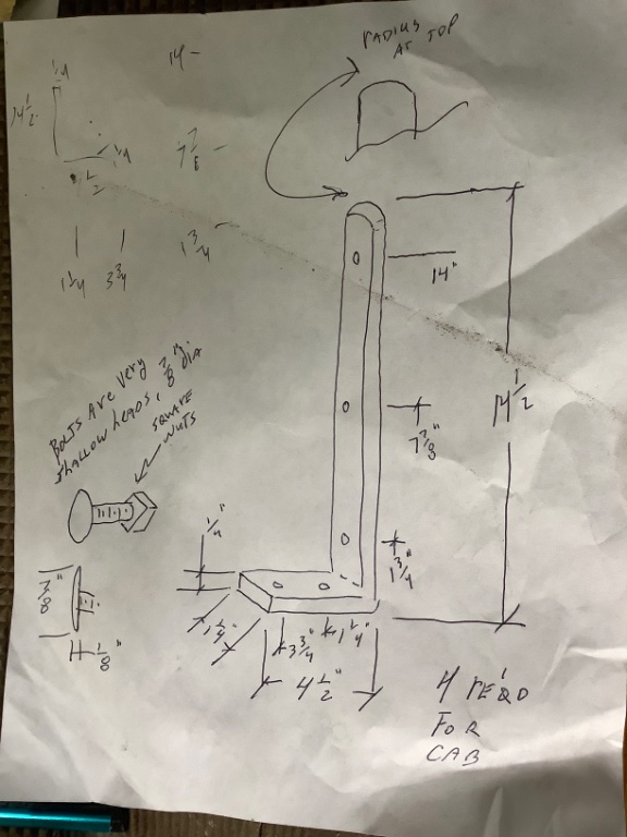

One of my panels measured .039. That would be 19gauge steel or perhaps 20ga. Kind of in between . You can see the pinstripe location peeking out under the orange it had been painted at one time. Yes, pinstripes on a lowly truck cab!
Posts: 2844
First Name: Dallas
Last Name: Landers
Location: N.E. Indiana

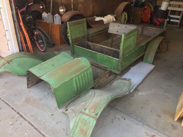

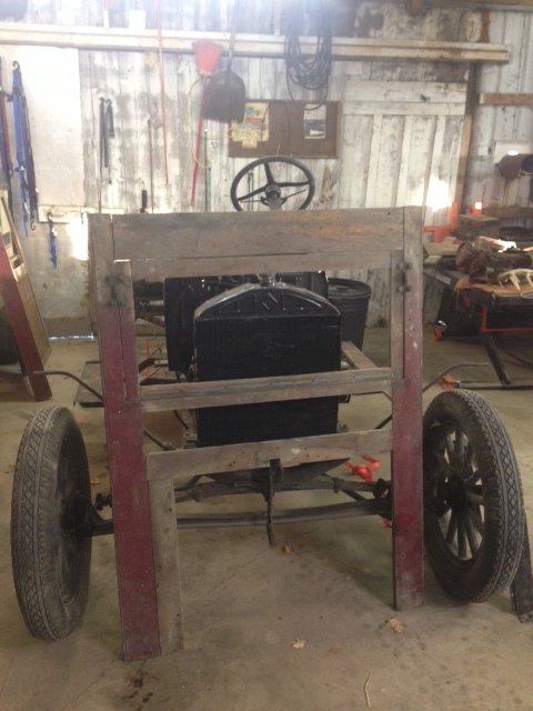

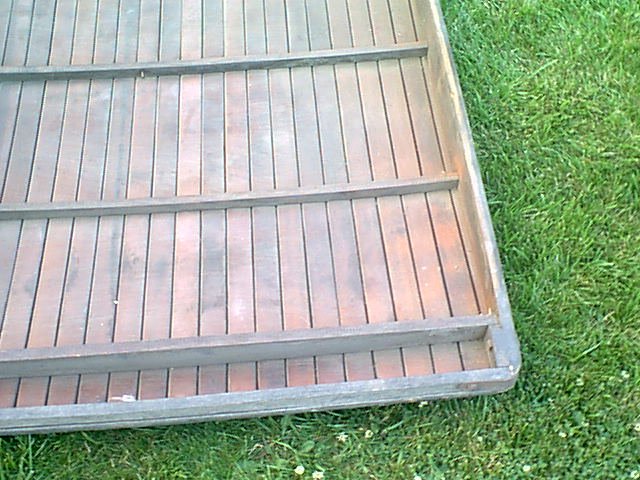

Post by Dallas Landers » Sun Jun 06, 2021 6:37 pm

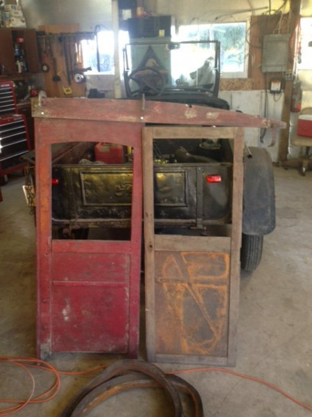

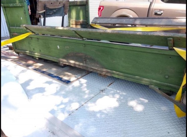

This is what I started with. I had one side , two doors , one top bow and the cab front.

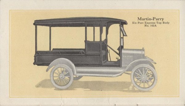

Post by Art Ebeling » Sun Jun 06, 2021 6:48 pm

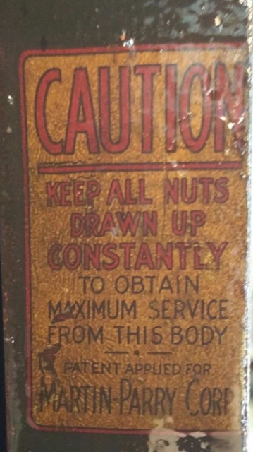

I think this has already been posted on this forum but it is my favorite part of a Martin - Parry body.
Dropacent
Posts: 3384
Last Name: Morsher
Post by Dropacent » Sun Jun 06, 2021 6:55 pm
Thanks Art. With Steve Lang’s help, I had some of those decals made up. I will send free to any M-P owner. Tmorsher@icloud.com to get one on the way.

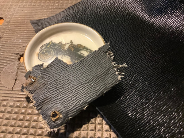

I was cleaning out a desk today, and found this. It was a small remnant that came off of a very original T M-P delivery truck I had years ago. It gave me every indication that it was original to the truck as it still had all the special little steel stamped pieces M-P used on the corners, and likely those would have been pitched in time, or just rusted away. So, I have only this example, and it matches perfectly high grade long grain top material. Not the fuzzy back cheapo stuff.
Other original bodies may show something else, but this is what I have found.
dmdeaton
Posts: 732
First Name: Danny
Last Name: Deaton
Post by dmdeaton » Sun Jun 06, 2021 8:26 pm
Looks close to Turf Grain on the roadster tops?
Dropacent
Posts: 3384
Last Name: Morsher
Post by Dropacent » Sun Jun 06, 2021 9:27 pm
An upholsterer or upholstery shop would call it Cobra grain. Any big city should have a shop that can order it for you. Miami Rubber is the big supply house I know of, down your way. Perhaps they would sell direct. It used to be professional shops only , but business has changed a lot since I was in business.
Just stay away from the fuzzy white backed stuff.

If anyone is wondering why there is a fuzzy style and a clean backing style here it is..., Fuzzy is for gluing to a continuous surface completely like a vinyl top material (weaker) and smooth backing cloth is for stretching (stronger) and attachment on the edges only.

That’s correct, Hank, but I’ve never seen fuzzy backed long grain glued down. In the mid 70s I was installing two vinyl tops a day, and ford used a lot of the fuzzy backed stuff. ( glad I didn’t stick with that career ! ) The samples I’ve seen currently have a real ugly rubbery look to them. The cloth backed cobra has a good appearance. Buy from a reputable source, is my only advice.

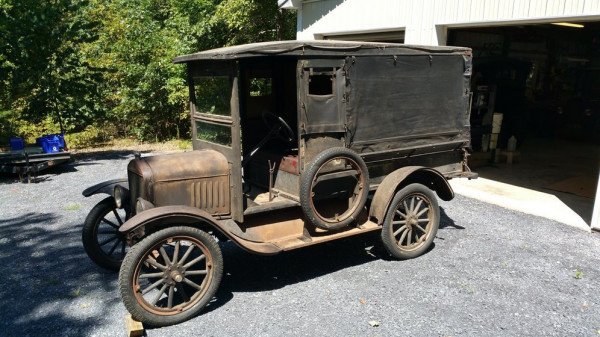

My 26 with 24 front end West Hurley NY Fire Dept Support Vehicle with the 25 Martin -Parry TYPE C with Roller Doors is the last one shown in the 24-27 Registry Section of the MP website. Fortunately 99% of all the metal was in good shape to include the patented double action door locks, rollers, rails, and door and side metal panels. So if you have needs in that area contact me. All wood replaced and a lot of oak.

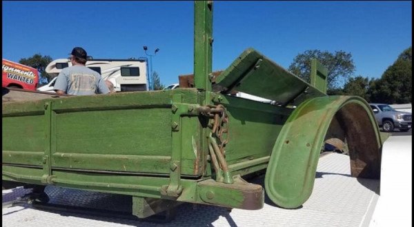

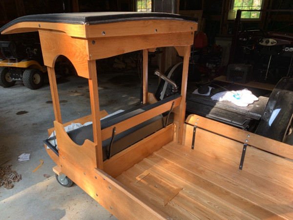

Post by Matt in California » Tue Jun 08, 2021 1:52 am
I am excited to find this M-P thread! For those who have followed they have seen $1000 build: https://mtfca.com/phpBB3/viewtopic.php? ... 54#p132954
Here are the M-P parts that I purchased:
Note 1: front fender, hood and splash guard are Ford, but the rear fenders are M-P.
Note 2: the body was cut at bout 12 inches above the bed. The green paint was added, but inside you can see the natural state.
Matt

Here is what my M-P likely originally looked like (162A Six Post Express Top Body):
KIC Document 7-A-1.jpg (36.03 KiB) Viewed 12724 times
Under the Dealers Catalogs - Early Bodies for Fords (see: https://www.martin-parry.com/early-bodies-for-ford.html), I found this.
Martin Parry 167 Light Open Express Body.JPG (63.61 KiB) Viewed 12724 times
This supports the idea of putting the body on an earlier car. My thought is on a 1915 to match the engine I am considering using. I didn't get the windshield with the body, but I don't think that is an issue because for the 162A and the 167 that was at an additional cost (a whopping $11.85). So some people must have stuck with their original cowl. Like this example (see http://www.coachbuilt.com/bui/m/martin_ ... _parry.htm):

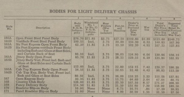

Here is the 1923 price list (see https://www.martin-parry.com/dealer-s-c ... bined-pric):
Martin Parry 1923 price list.JPG (45.16 KiB) Viewed 12724 times
It looks like I got over charged :o Note "special commercial fenders" were only $3.75 (including war tax).

Post by Matt in California » Tue Jun 08, 2021 2:22 am
I found the following photos of an amazing survivor that is probably exactly how this express started (see: https://www.martin-parry.com/car-regist ... -1927.html to enlarge photos and very nice article).
Martin Parry 1924 Six Post Express Pickup.JPG (92.71 KiB) Viewed 12723 times
I see the current owner is here on the forum (see http://www.mtfca.com/discus/messages/50 ... 1440771497).

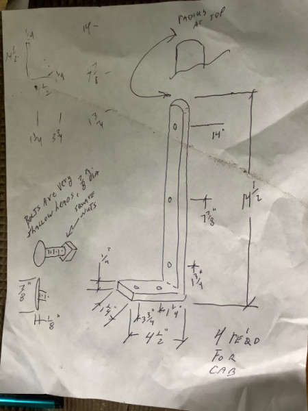

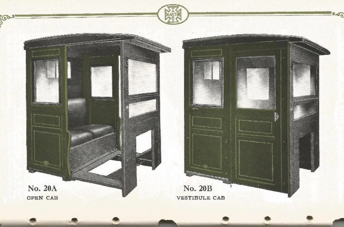

As I find info around here I will add. The following are some details for a truck cab #20 B like Dallas Landers truck. A couple of pictures are his, showing the body in white. Note the details of M-P metalwork, as these are great identifying features showing the M-P details. I’ve recd several emails in the last couple days asking if their body is M-P. Referring to the online archival catalogs are a huge help. ( thanks again Ben! )

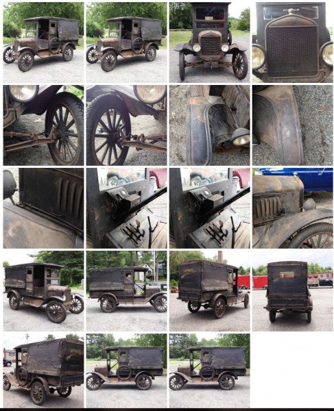

Post by Dropacent » Tue Jun 08, 2021 11:19 am
About 4-5 years ago, an amazing original M-P #20B was offered for sale at the Marietta swap meet. I had been searching for years for info on what the small metal door handle holders looked like, with no luck. I had evidence of something screwed onto my cab, but no idea what it was. I was able to purchase these separately from the cab before it sold. We would love to know where the cab ended up, and if anyone knows, please send me an email. Likely somewhere in southern Ohio or West Virginia now. Tmorsher@icloud.com Here are the small metal parts, used to hold door in open position while driving. Simple , lightweight, yet very affective.

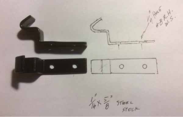

Post by Dropacent » Tue Jun 08, 2021 11:23 am

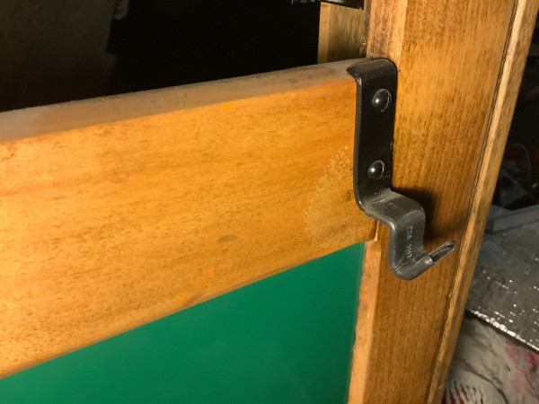

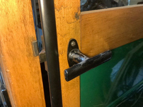

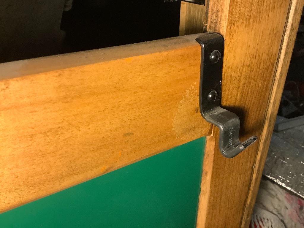

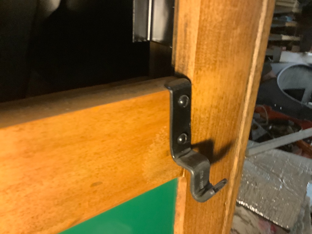

This is the side body to body sill mounting bracket. We know for sure used on the #20 wood cabs, and perhaps on many other body’s. Remember Dallas’s statement, that the bodies are built with the ability to flex. Another key point in authentic M-P body construction.
Posts: 2844
First Name: Dallas
Last Name: Landers
Post by Dallas Landers » Tue Jun 08, 2021 11:28 am
Notice one screw in mortis joint.
Dropacent
Posts: 3384
Last Name: Morsher
Post by Dropacent » Tue Jun 08, 2021 11:29 am
Another key detail is the stiffening rib on the metal panels. This was probably the key detail that helped me identify my cab maker 20 years ago.
Dropacent
Posts: 3384
Last Name: Morsher
Post by Dropacent » Tue Jun 08, 2021 11:30 am
Dallas, they knew K.I.S.S. before it was a thing !

Post by Perry Goble » Tue Jun 08, 2021 5:49 pm
I am in the process of restoring what I believe is a 1917 Model T Ford with a Parry Depot hack body .I researched many sources , books and the intranet .The MP website mentioned was a great help .It gave me many of the clues that led me to the conclusion that my car body is a Parry . First the Model T is a 1917 it has all the typical 17 parts . With Firestone heavy duty wheels and the rear springs have heavy duty shock absorbers on them .I thank the body was put on this chassis when both car and body were new in 1917 . Now the clues that brought me to the conclusion that it is a Parry body .The MP website said Parry and Martin merged in 1919 . 1917 is before the merge . The1917 Parry catalog says that the Parry started putting metal doors on there bodies in 1917 . My body has a metal fake door on the driver side and a metal door that opens on the passenger side. Typical wood doors in the back . Parry supplied rear fenders painted green . There traces of green paint on the MP style rear fender on the car , I need a MP passenger side fender if anyone has a spare . The body has the same door handles that are on MP depot hacks .Lots of metal brackets much like MP bodies . I all so need a front Firestone wheel . The car has three a like and one oddball .

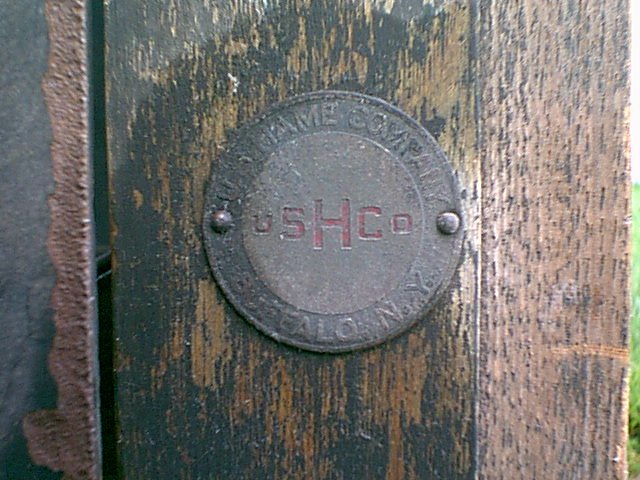

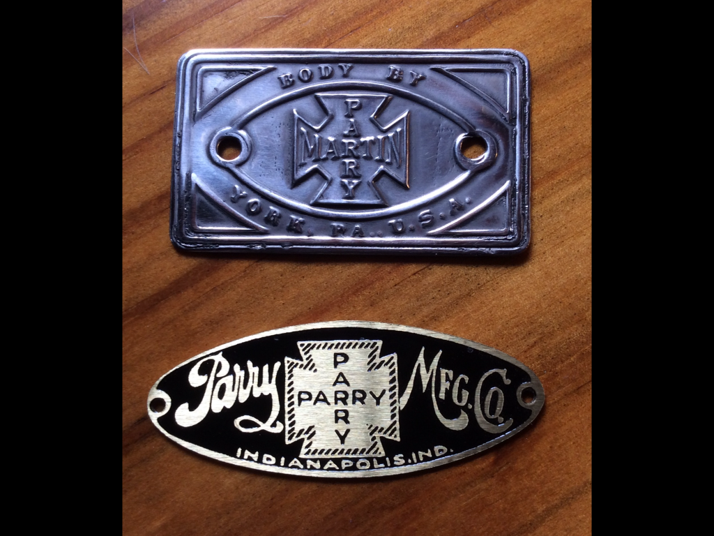

Body tags
Perry Goble
Posts: 262
Joined: Thu Mar 07, 2019 3:26 pm
First Name: William
Last Name: Goble
Location: burnet tx
Post by Perry Goble » Wed Jun 09, 2021 11:51 am
Tim do you have a spare Parry body tag you would be willing to sell ?
Dropacent
Posts: 3384
Last Name: Morsher
Post by Dropacent » Wed Jun 09, 2021 11:58 am
I’d give you it if I still had it. Jack Daron had these made up years ago. His sons have been selling some of his things after his passing, perhaps someone in southern Indiana could share contact info for them.

Post by Matt in California » Thu Jun 10, 2021 12:07 am
Where were the tags located?

Post by Dropacent » Thu Jun 10, 2021 10:48 am
Matt, body tags were very common on custom bodies. Not just M-P but on any thing built in some quantity. It was gorilla marketing. Back then, the money side is generally the passenger side. This is how people generally entered and exited vehicles from the curbside. From examples I’ve seen, tags are located on the lower edge of the cab, or on the seat panel where people can easily see it upon entering. Advertising! Not on doors as doors were easily removable.

Post by henryford2 » Fri Jun 11, 2021 8:45 am

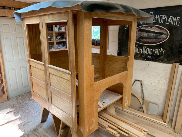

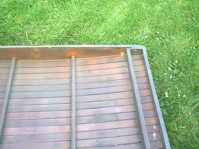

Roof Detail from a body I rescued years ago from the top of a barn. Enjoy

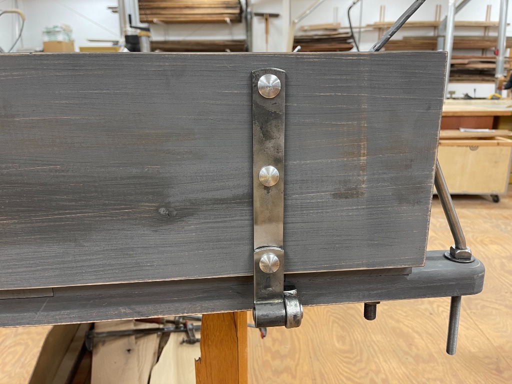

A couple of comments on the panel construction. There are so many types of bodies it’s hard to make blanket statements, but here are a couple. The bodies main construction is made out of solid wood. Wood is organic, and generally moves,FOREVER. Growing and shrinking with age and moisture content. This varies on the type of wood, and also the atmospheric conditions the body lives in, but one guarantee, it will move. This is problematic to the panel construction, and M-P handled it very well. For the metal panels like Dallas’s truck has, the slots are deep enough that the panels can move as the wood moves. If not, the body will self destruct in time.
In examples that I’ve seen of wood panels, 3 ply plywood and also 5 ply plywood. You would think solid wood would work, but this raises different issues. Primarily, solid panels will split in time. Secondly, solid panels can be quite large, and making them out of solid wood to eliminate glue joints would be even harder. M-P had a unique method of installing panels on their station wagon bodies that allow the wood movement any direction without the wood damage. The finish may suffer slightly, but that’s better than a body exploding.
Over the years I’ve seen beautiful bodies built by craftsman that will certainly self destruct. The type of joinery that will maybe work for living room furniture will certainly be doomed as vehicle body construction. Movement, even slight movement must be addressed in every aspect.
Also, their use of light metal brackets , braces, straps, carriage bolts, etc allow the slight movement of the wood.
Hopefully when someone starts building a project , they can share some of these details, that will be very helpful in any project construction, not just a M-P body restoration or recreation. Someone a lot smarter than me said “ Do It Once And Do It Right”

Post by Bpurkey » Sun Jun 13, 2021 6:52 pm

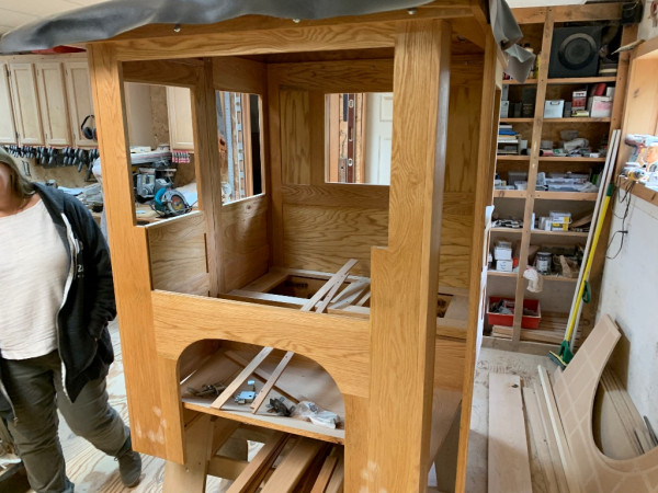

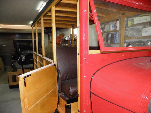

As Tim pointed out, wood moves as moisture content changes. On my 1928 M-P Station Wagon, the original doors had pretty much fallen apart at the door frames. On the 1928 there was no plywood used, all the wood was solid pieces. I decided that the solid wood side panels and door panels were the culprits.
I wanted to stick with the original construction as much as I could so I used solid maple for the panels. Wood moves mostly in the perpendicular dimension to the grain, and very little in the parallel dimension. Therefore, I did not worry about the ends of the panels, but the sides of the panels were a problem. I could not find any solution to the problem as it had been originally constructed, so I cheated. I left a small gap (about ¼”) underneath the center external horizontal molding strip to allow for movement of the wood. Since I didn’t want this gap to show on the inside of each panel, I added a wood strip on the inside to cover the gap. This strip was not part of the original construction. The strip can be seen in the attached photo. So far, I have had no problems with wood movement.
Posts: 7322
Post by Allan » Sun Jun 13, 2021 9:26 pm
Ben, I had the same problem with the doors on my 1917 shooting brake. Over the seasons, the horizontal joints in the door side panels open and close as they are wont to. What I should have done is made the joints a lap joint, so that they could still move but the overlap would disguise the gap. I kick myself over this.
I always cringe when I see tongue-and-groove boards, often clamped tightly, used as boards in the bed of a truck. If it gets wet it will self destruct. An old timer taught me to make lap joints in this application, with the addition of clear space on the flats as well as the sides of the lap. That way, with a gap set between the boards and a gap between the lap, water runs straight through, and the boards are free to move, as they do.
