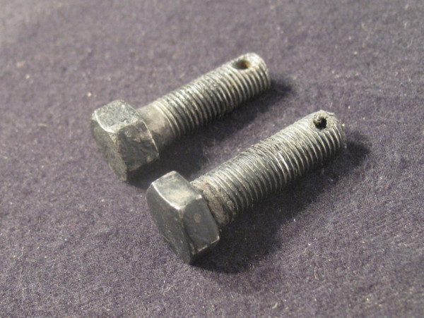

The basic question here is "What's correct?" As any car contains dozens of different fasteners, there are dozens of answers. Here's one.
Two 3/8" bolts. One is an original Ford bolt, easily recognized by its taller head. The other is a modern bolt from the local farm supply store, adapted because I didn't have enough originals. The adaptation: 1 Drill the cotter pin hole; 2 Grind and buff the modern markings off the head; 3 Strip away the cad plating with muriatic acid because paint will flake off the plating; 4 Prep the stripped bolt with phosphoric acid to etch the surface for paint adhesion; 5 Paint and bake.
This list gives you the sizes of many chassis fasteners, but not all the details. Details? An example would be the ¼-20 carriage bolts holding the coil box to the firewall in my runabout. The head is slightly smaller than on a normal ¼-20 carriage bolt. If you use a normal bolt you have to grind a little flat place on one edge of the head to make it fit.
