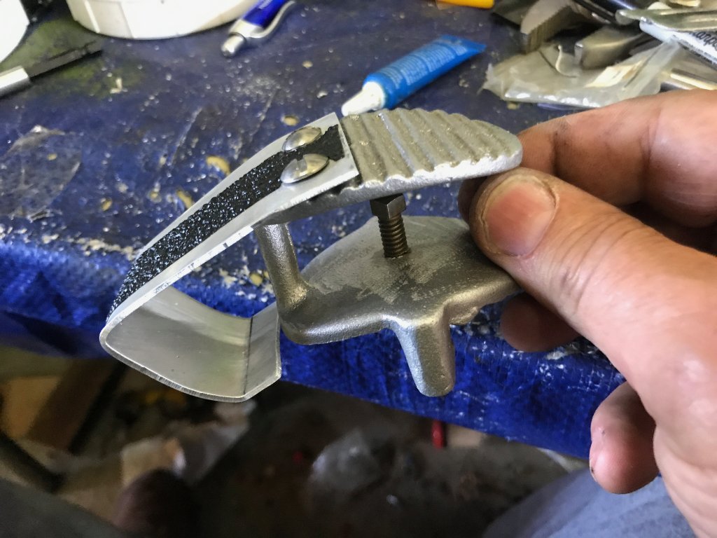

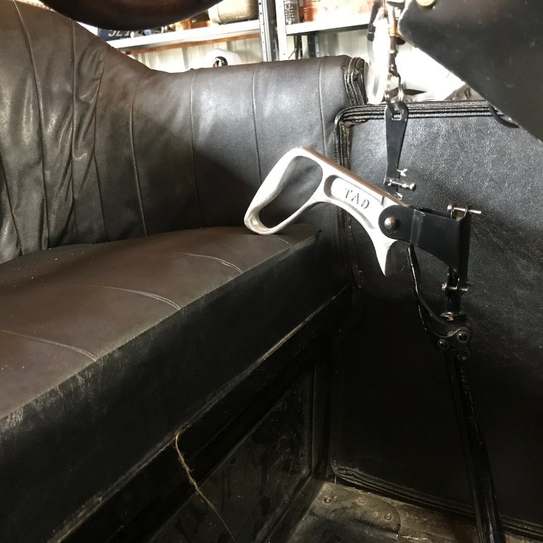

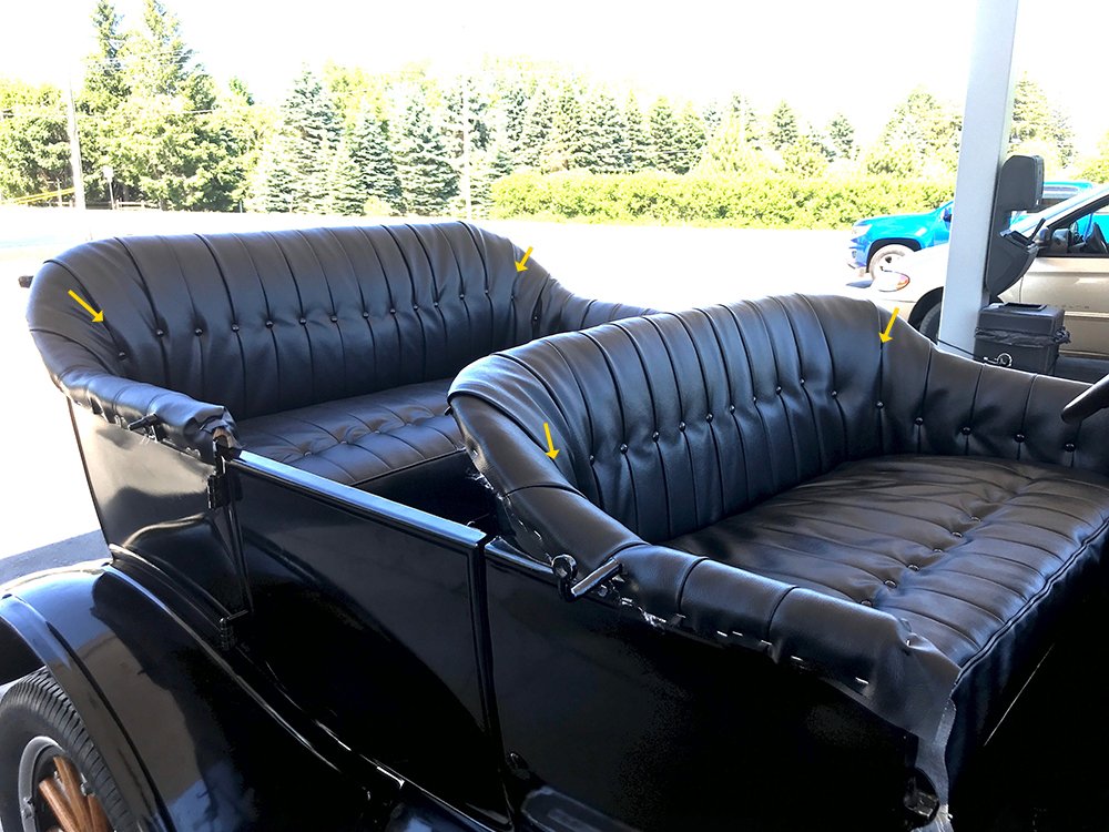

I'm a big guy with big feet (14's). I fit comfortably in my 1917 Touring. In my opinion, open cars are a little easier to get into.
In my car, the springs in the back of the front seat were removed by a previous owner which gives a little more room without damaging appearance or comfort. I added extenders to all pedals to accommodate my big feet and an extender on the "brake" lever to accommodate my shortening arms.
FWIW - the 1911 & '12 Torpedoes are reputed to have the most leg room but they are rare and pricey. The cars up to 1920 had 15 inch or smaller steering wheels - after which they were 16 inches for a few years and 17 inches in the last couple of years of production. I've heard the later cars have less room but have no personal experience to bear that out.
To echo the advice of others, don't buy a car without first sitting in it or a car like it.
