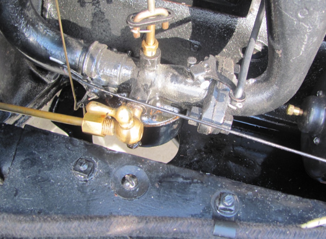

There are many ways, but IMO, just a long "L" bend in the end of the wire. That will allow you to 'pull' away on the middle of the wire, while at the same time pull the choke lever, holding it to closed position, and pull the long part of the "L" out from the choke lever.

Re: NH Radiator Choke Rod End Bend
OK..
I see it as a Long Tail 'Z' Bend.. That gets me started.. I'll play with welding rod before I bend the Actual Part.. The Brass Rod I got for it is REALLY Stiff to bend.. Mild Steel is Softer than this stuff..
That got me started..
I could not get the Long Tail Z Bend to start into Arm 'Eye'.. So I bent a little different.. A Little bit of a challange to thread through the Rad Hole, but a little wiggling and it goes..
This is a Short Arm NH. Dan's Pic looks like a Long Arm Carb.
Cap

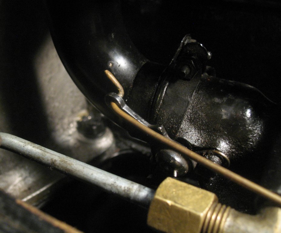

- Posts: 7395
I made mine a lot like a couple of the others. The slight upward bend at the end facilitates poking it through the arm hole. I believe I used 3/32" brass welding rod. I have no trouble getting it through the radiator hole, even with a rubber grommet. Not correct? I don't mind.

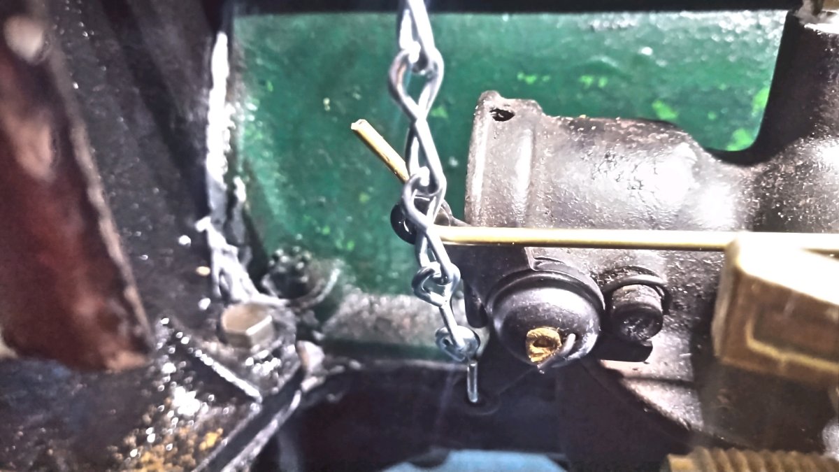

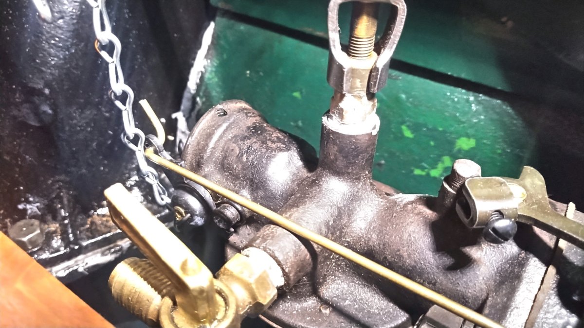

From a post in 2009,
http://www.mtfca.com/discus/messages/80 ... 1252680540
"For the carburetor end, bend the wire about 80 degrees in toward the carburetor, and go about 3/16" in, and then straighten it out again. Cut the wire about 1/4" past that."
