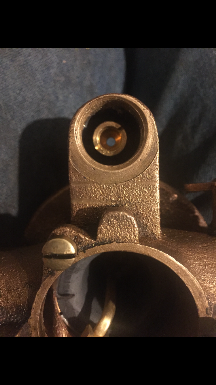

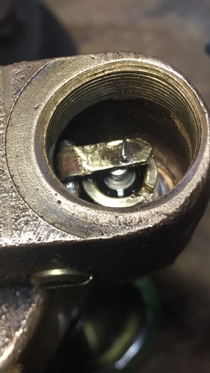

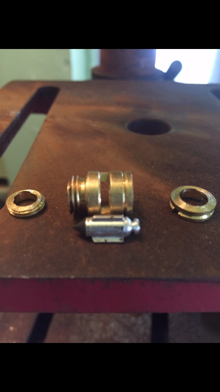

The H1 is the same as the G with a different float/float valve arrangement. The venturi, idle pickup tube, jet and bores are the same. After a year of the S, they went back to the H1 design but with a simpler and more reliable float valve.
You can modify the needle and seat from a GM Quadrajet and make another float arm to have a modern leak-proof setup. You don’t even need a lathe, it can be modified with a drill press a hacksaw blade and a file, drill where the original needle seated and tap 3/8”-24 and used a lead washer.
