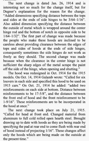

This info is from Bruce McCalley's CD encly. Is part of Trent's research on dating brass hoods.
Bit out of focus but had to enlarge the screen shot.

Thanks all! It is a Runabout. Will be on the lookout for a smooth side hood.
