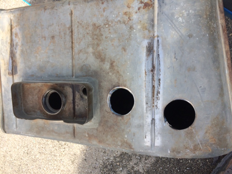

Made a couple of access holes in the top of the tank.

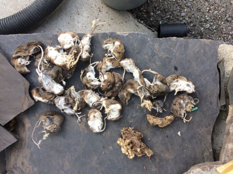

About 40 mouse corpses in the tank (along with a LOT of mouse bait and grain and upholstery fuzz)

Good idea using a holesaw to cut the holes. Or did you use a knockout like a electrician uses.
Which ever it’s a neat job.

Used the shop vacuum for most of it and a final wash out with the garden hose!

Finally, a better mouse trap!

How are you going to fill the holes you cut?

Could probably mix a mouse or two into a batch of JB Weld...?

Egyptian Mice? Or grave robbers? Any treasures?

OK, the hard part is done, but now you face a decision: Will you replace the old mice with new ones, or break with tradition and go with something more exotic, like colorful lizards or small birds, or go full custom with something like a nesting pair of striped bandicoots? Restoring fuel tank fauna can offer an opportunity to add a custom flair to your machine, so don't be afraid to be creative!

I too would like to know how you will fill the holes. My first choice would be an old soldering copper that you heat in an oven (a blowtorch works for this). I would not use anything with an open flame. About 10 years ago a former student of mine was working for a construction company. They decided to cut a 55-gallon drum into three sections to use for concrete footing forms. The barrel had held gasoline but had been emptied two years previously and left with the big and little plugs removed. About 1 second into the first cut with an oxyacetylene torch the barrel exploded, critically injuring the student who died in the hospital a couple of weeks later. I treat every gas tank that has been in service as if it contains gasoline vapors.

I have an American Beauty 300W soldering iron, almost too big for this job (a 150W unit would probably work). Found mine at a yard sale, just a suggestion! I would cut two circles an inch larger in diameter than your holes out of a matching thickness tin. If it's bare steel, I would use the iron and tin both sides of it, so it is "terne plated," like the tank was originally. Then I would fill the tank with water almost to the top panel with the holes in it. This is for safety's sake, just in case. Tin the tank for an inch around the holes. center the patches over the holes and using small sheet metal screws (not many) fasten the patches to the tank. Now with the soldering iron, solder the patches to the tank and solder over the screws. Use LOTS of flux so you get a good soldering job. Test for leaks, water is thicker than gas though. . . . so to test, thinking of a tank of water, stopper up all the holes in the tank and put about 5 lbs of air to it and put in tank & look for bubbles--allow about 5 minutes for them to form, if they do!
Also, while you are in there, you might want to re-do the vent tube because all those mice might have caused it to rust a bit!
Be Safe!! That tank still likely has some gas in it!!!

Firstly, this tank has probably been empty for at least 50 years!! So NO trace of fuel vapours!!
I plan to solder a patch of galvanized metal to it.
