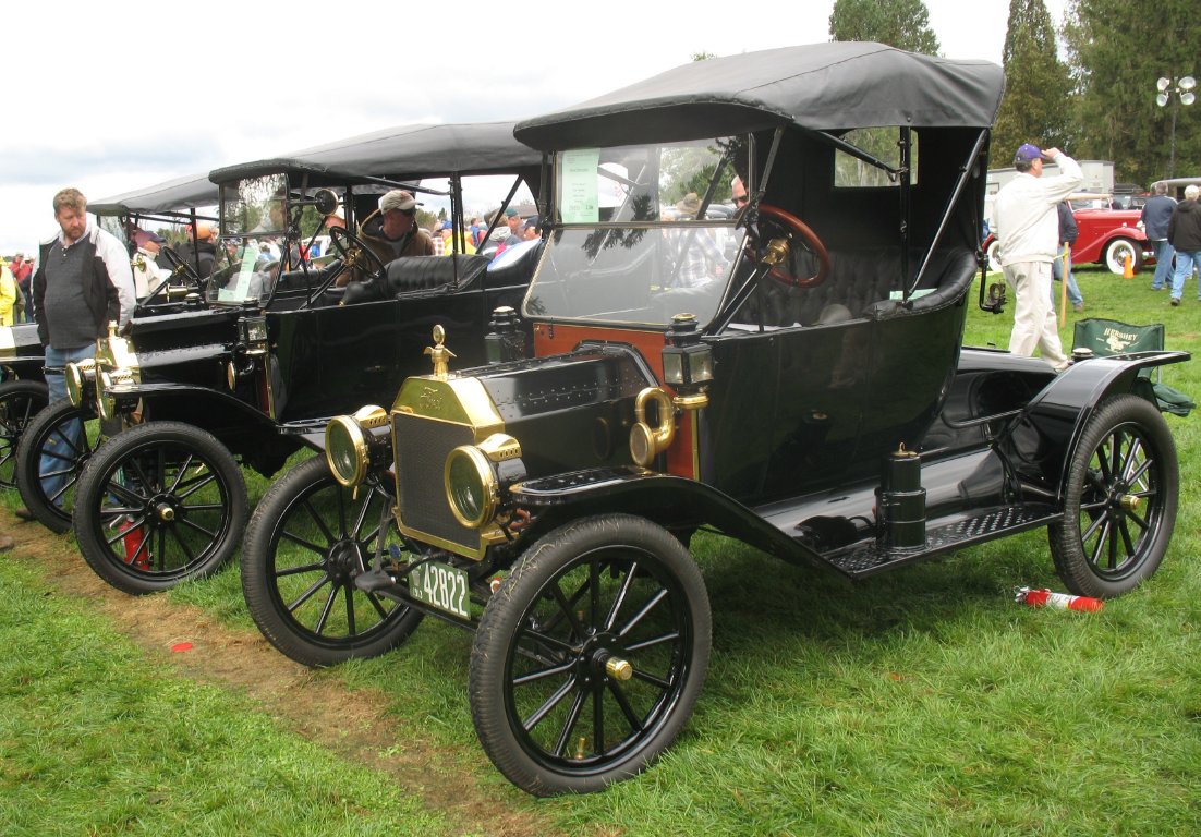

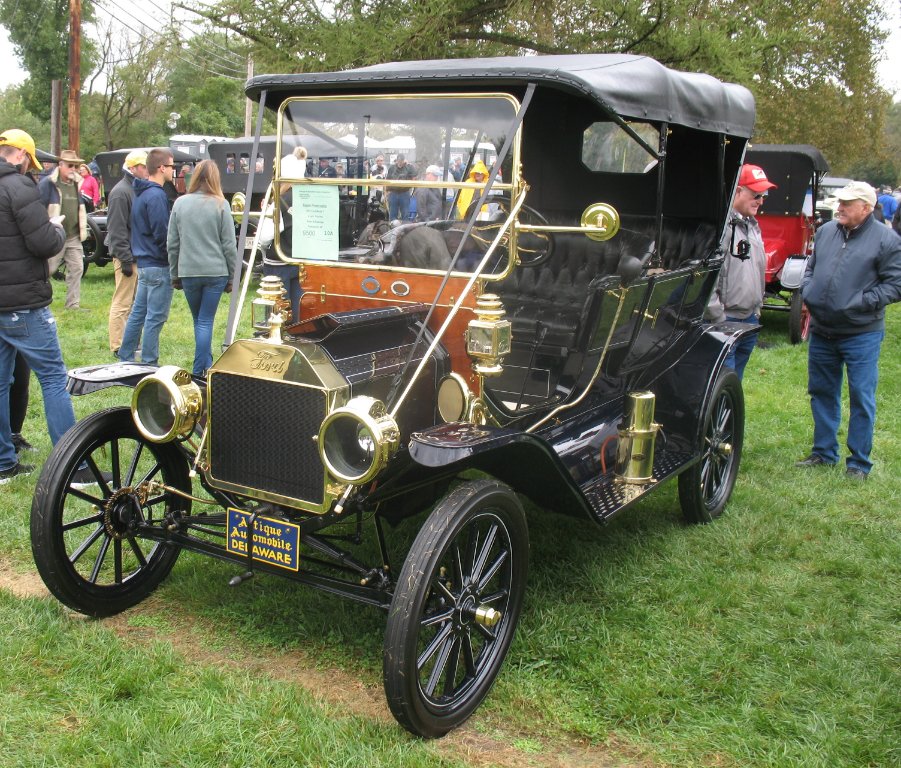

Some tires at Hershey.
Pete Ratledge shows his 1911, but he also drives it a lot.
Most of the brass fords wear black.

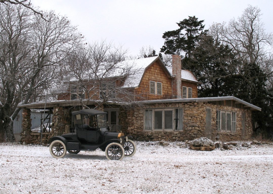

I think this 1915 looks good in black.

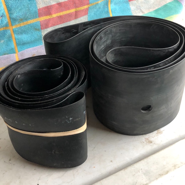

When I was coming up Pop ALWAYS used flaps in whatever car we had (not Model Ts) until tubeless tires became popular. He said they protected the inner tube from pinching. This was an article of faith from when he came up in the 1930s.
When I installed the New Zealand Firestones on the '23 Runabout I used flaps, I didn't even consider not using them. So far, no flats.
Now I read here on the forum that Ford did not use them and many modern T owners don't either. Possibly time for me to rethink this . . .

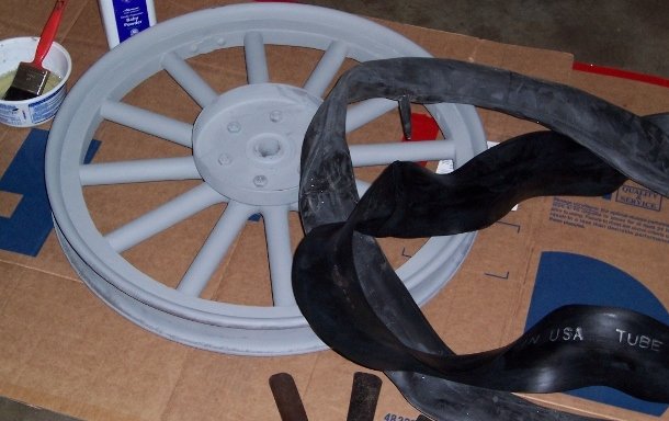

I recognize that the situation is different in Europe (EU) but I needed 2 new reartires for my '14 touring and choosed Blockley as I liked the period pattern and believe they where similar price as the "traditional" brands. I also bought 4 tubes as I needed them for 2 sparewheels for another T.
I have never used flaps. I tried as I was told I had to, but I could not make it work mounting them. I have had issues with puntures, but that was some thin tubes bought at Snyders via a local danish dealer (and funny enough they where made in Denmark!!!). Since I have found and bought some thicker tubes and have had no issues with punctures in any of my now 3 Model T's.
I must admit though, that when I mounted the Blocleys, I brushed the inner side of the felloe with a steelbrush and then applied ducktape to make the inside smooth. It might also help at the mounting.

Ron
before I proceed, you should know that there are two terms often misapplied when discussing this topic. It hasn't come up yet in this thread, but has in others, and that is the difference between a Rim Liner and Tire Flap. A rim liner is a thin rubber strip which is stretched around the rim...some folks swear by duct tape as an alternative. When I was at your stage of the hobby, I became convinced that I needed to go the Duct tape route. What a gawd-awful mess I found 2 years later. Investigating the situation I discovered that I did not need a rim liner, but a tire flap. A tire flap is a heavy rubber flap (more than a strip) which is moulded to have a curve in it. The tube is placed into the tire and inflated to about 3-4 # so as to hold it's shape and fill the tire without wrinkles. The flap is installed over the tube and tucked under each bead of the tire. The molded curve of the flap allows it to hug the tube and conform nicely to the inside of the tire (there is a single hole in the flap for the valve to stick through). The valve core is removed, allowing the tube to deflate entirely, and the tire can be levered onto the clincher. I do both beads at a time, starting with the valve area...tire is pushed over the clincher, valve pushed through the clincher, about 7" of tire on each side of the valve seated fully with a rubber mallet and then work your way around with a tire iron, popping both beads on simultaneously. The rest is normal stuff, as in inflating and deflating the tire several times to allow the tube to find it's final resting spot without wrinkles or pinches.
The flap will come with a sticky coating which I have found will make your hands filthy, but I get best results by leaving it on the flap. I do not know if it is a mold release agent or some sort of wicked rubber lube, but things just seem to work better by leaving it on. I use talc or Ruglyde to make the beads slick and want to go over the clincher...which one I use depends on how long it takes to find the bottle of Ruglyde.
I get things likd Flaps from either Chaffins or Lang's and do not know if there are different mfgs or not. I have always been happy with what I receive. They are a one-time purchase and will outlast you, your tires and maybe your car.
I do not have a picture of a flap installed, but suffice it to say that it is inside the tire, supporting the tube at the clincher opening. It is made of a substantial cross section of rubber, well in excess of the tube wall which is thickest at it's midpoint and tapers somewhat to the edges, providing the most support where it is needed the most. I'd estimate that it envelopes about 1/3 of the diameter of the tube.
A picture of a rim, tube, flap (the thing marked "USA TUBE"), courtesy of MTFCA and Dan Treace:

Your post was very clear on the purpose of flaps in today's modern tires. Have used flaps in all my clincher rims for 20 years. Makes tire mounting easier and saves on tubes as you wrote. BTW, Ford factory used flaps in Split Rims, and should be used today. Ford Service also warned with the marketing of the new wire wheels in 21" size Not to use flaps in drop center rims, that will cause issue in install or removal. Once had to pull a tire off a drop center rim Ford wire that someone foolishly put in a flap, that was a chore!
Just one thing, I got a recent batch of flaps from Langs. 30"x 3 1/2" flaps to install in a Firestone tire, BUT....these pair of flaps when received weren't going in my tires.....no way. This pair was HUGE, bet they are Truck Flaps, too wide, and no molded curve or taper to fit to the narrow tubes used in T tires.
I called Steve Lang to let him know others will likely complain, fortunately for me he had two slightly used flaps on hand that he just sent me.
Note the proper flap on the Left, Made in USA and marked for 23" rim, with marking to note "tube to this side". These are correct and what I have always used.
Seems that Lang's and maybe others can't get the proper flaps now, maybe a supplier issue, or Covid19 issue or what ever. But the large, wide, flat with no taper flap on the Right just won't work!

Scott, the photos you posted tell a story. However, only part of the story. The first one shows a rim section which has the bead turning back on itself, not the usual profile. I suspect it is a modern replacement.There is no way the tyre can properly fit in that bead. We are not told whether that is for the narrower front wheel. We are not told whether that section of tyre is from a 3" or 3.5". The fact is, when properly fitted and inflated, the overlap in the centre of those beads will disappear into the rim beads.
The second photo shows a proper clincher rim. The tube type rim liner I fit is cut to the width of the outer edges of the A's you use in the illustration. As such, they lift the inner edge of the tyre bead, and make the bead a better fit in the rim. The totally isolate the tube from the rim.

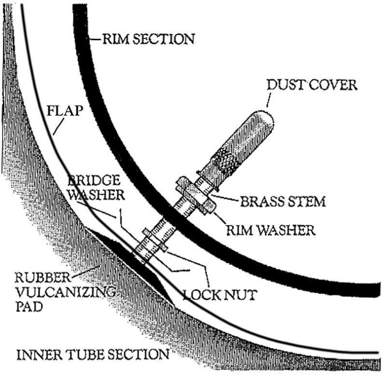

Question for Scott - looking at the cross-section of the Universal T driver, would you use a bridge washer between the flap and rim to reduce tension from the stem pulling on the tube when the rim nut is snugged down? Blockley says no Bridge washer required but will the thick flap be enough to prevent the tube from being pulled down between the beads if you don't over-tighten the rim nut?

Tim, regarding bridge washers and Blockley tubes: I don't know one way or another
I'd be inclined to follow manufacturer's recommendations until such time as they are perhaps shown to be faulty
Allan, to your points regarding the pictures, they are not my pictures and were selected from MTFCA archives to simply clarify discussion points.
