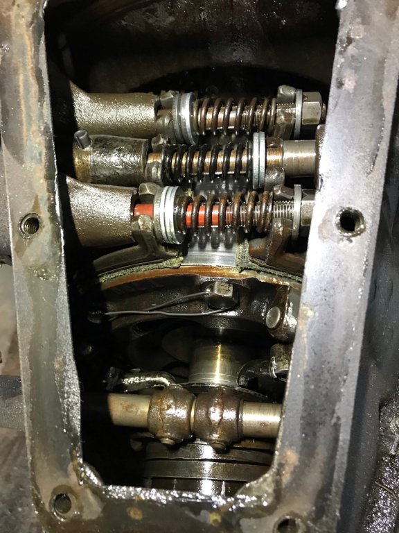

sad to say, but there is so much wrong going on in your pictures, that it will take a list:
Washers are increasing tension on springs but at the same time are limiting travel due to potential bottoming/binding of the coils. Compression springs are designed with a certain number of coils, wire diameter, and spring rate to operate in a designed range but not be over-compressed. Simply pre-compressing them is not the answer to making them stronger. Washers need to come out and correct springs installed.
The roll pin will shear far sooner than later...at best you will lose low gear, at worst some of it will fall into the bowels of the transmission to play havoc with things
Linings on bands are not new though the engine is
Wrong washers are on the ends of the reverse and brake cross shafts and will allow nuts to fall off. At best, pedal adjustment will become looser and looser requiring constant attention, or worst, on a longer drive, will vibrate off with serious consequences.
Pressure plate wiring is not particularly robust, but this sort of thing is starting to get down in the weeds and pale in comparison to the above items
I think you have your work cut out for you getting this car sorted out. You will be well served by finding someone knowledgeable nearby and get them to adopt you and your car and help you work through things.
With this knowledge in hand, I will tell you that your car becoming stiffer as it gets hot is not at all normal. I think everyone is putting on their best face and encouraging you, but the evidence the transmission is presenting leads me to believe that some common things that can be considered acceptable for a modern engine have been put to work in a splash system engine and the end result is a bit of a crap-shoot. As others have mentioned, you very likely have wrist pins which are too tight or pistons that are fitted too closely. Pay very close attention to noises or power-loss and consider a flatbed rather than gut your way home if something really doesn't goe right. These things do not get better.
good luck

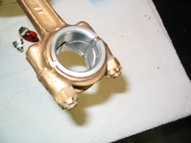

Some have suggested to check wrist pins, I see you say a re-build some 20 years ago. A big problem with pistons back then was there was no oil holes drilled to lube the wrist pin by some piston manufactures and a big problem as you are having now back then.
do you have a picture of what it should look like? I'm getting closer to the point where I'm going to pull a piston to see what's going on and I'd like to know what I'm looking for. Is it just a hole drilled from the bottom into the pin boss of the piston?
Kerry
Posts: 1460
Last Name: van Ekeren
Re: how stiff is too stiff?
Post by Kerry » Mon Jun 28, 2021 7:02 pm
Yes James, that's what you would be looking for, about an 1/8" hole 1/2 way on the boss.

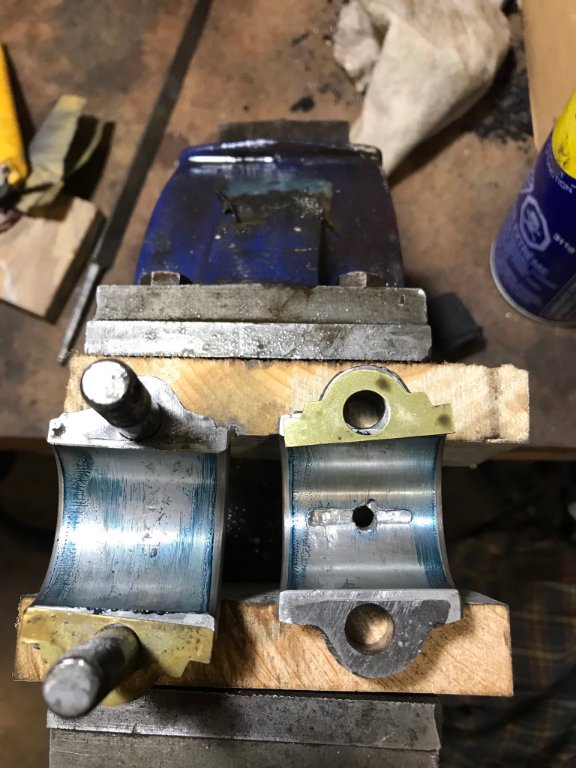

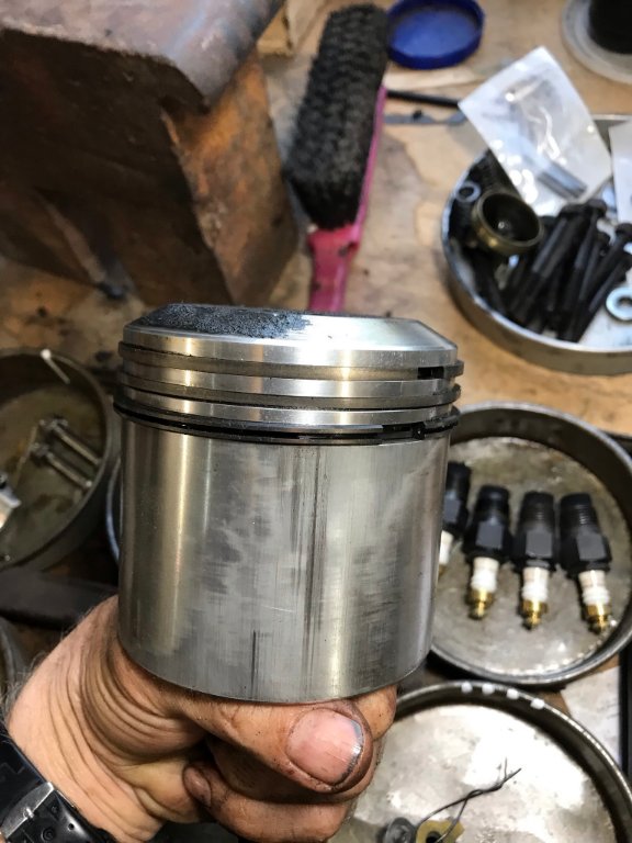

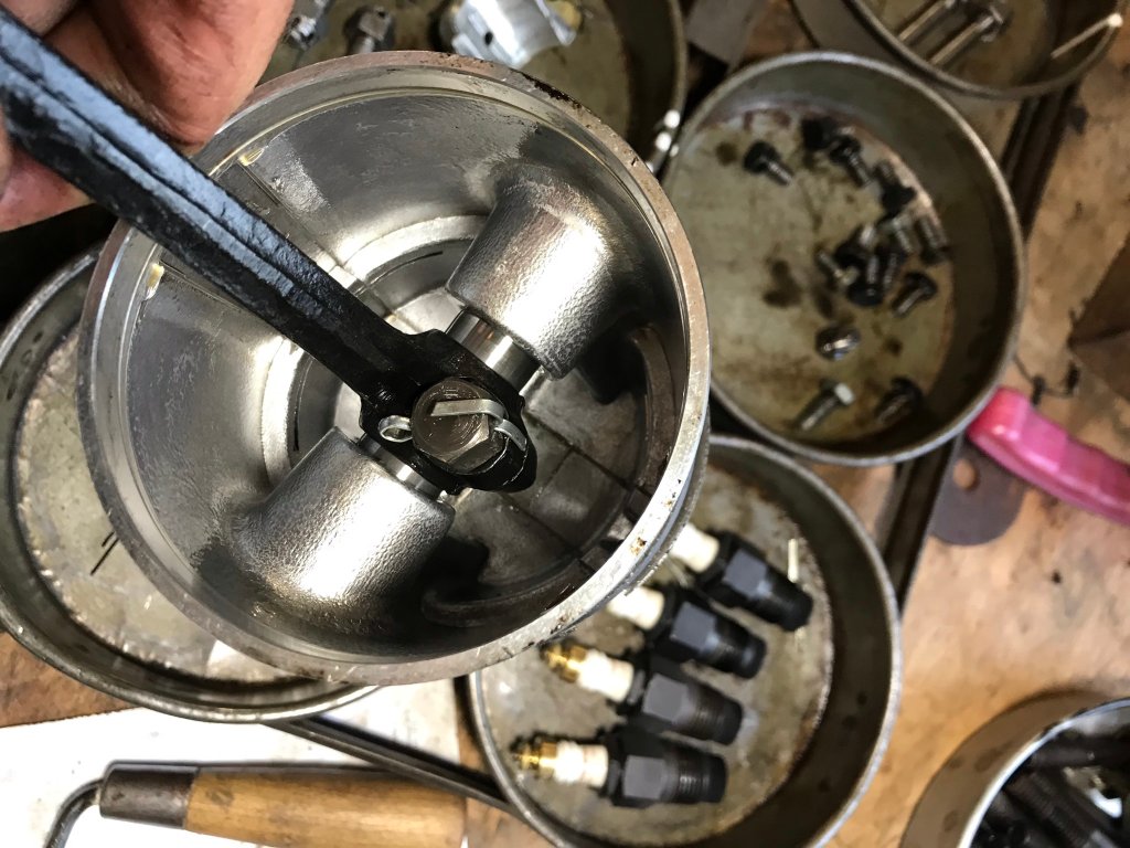

Post by JamesD » Mon Jul 05, 2021 10:57 pm
Well there's good news and bad news. :( :cry:

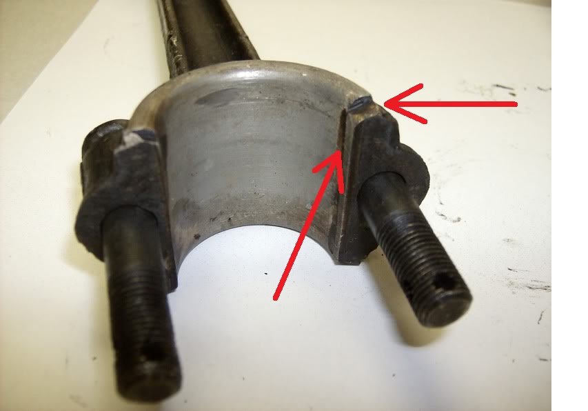

First the bad news: no holes in the pistons for the pin lubrication, #4 pin feels a tiny bit stiff, the rod bearing on #4 looks like it's damaged. Of course it has to be #4 on a 3 dip pan!
The good news: The crank looks fine, no scratches that I can feel, the cylinder bores look fine - no scoring. The other rods look fine
Looks like I'll have to find a T expert to redo the rod and check the other rods for straightness and hone the pin bushings. I'll mike the crank, the pistons and the bores to see what they are and check the clearance while I'm at it.
Anyone know of a good T engine guy in Manitoba, or Western Canada?

well, that's too bad...but better to find this out in the garage than on the road
as an FYI, when things are buttoned back up, consider this: study the cotter pin on the rod in the photo...then mentally reinstall it in the opposite direction, bending the right hand leg to the right and clinched around the rod...now it's functional. As it is, it isn't doing anything that would be considered helpful.
Best of luck. You're going to likely find that the crank is fine, though refitting #4 is going to be a $%^&. Not that awful to remove, but a doozy to lap and fit. Be patient and build a rag-dam in the back of the crankcase while you work. Some even go as far as to fabricate a sheet-metal tray that bolts in to occlude the chasm below the 4th rod. One day I'm going to make one myself.
Time-wise, if you're adept enough in the garage and are practiced at it, pulling the engine and removing the pan might (might) be as slow/quick as doing it in place and may require less Hail Mary's and repentance at the very least.
Kerry
Posts: 1460
Post by Kerry » Tue Jul 06, 2021 2:05 am

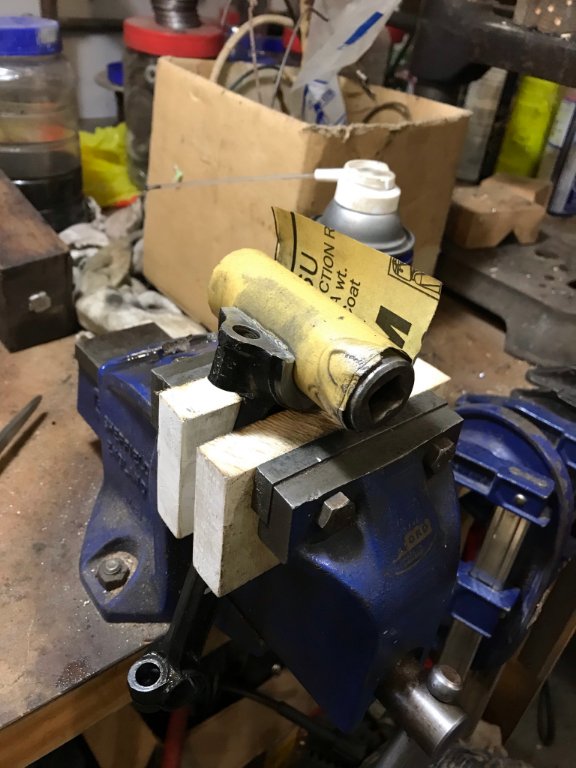

Some finer points are required on splash bearings for proper lubrication.
That #4 can be recovered to a good serviceable bearing. The problem was and is that at the parting lines of the cap to rod, had no oil swipes cut, relying on just the dipper is still not enough oil to lube.
Clean it up with 320 wet & dry sand paper with a lube (CRC) then a final finish with 1000/1200 paper. Check your B-end shaft sizes are all the same, if so the pick # 2 or # 3 so you have better room to work. You will more than likely find that not enough babbitt has been removed to warrant a shim to be pealed off but a light file of the cap would be enough to reset the oil clearance of .0015.
Posts: 8155
Post by TXGOAT2 » Tue Jul 06, 2021 8:19 am
Be sure that the brass shims did not and do not contact the crank pin.

Post by JamesD » Tue Jul 06, 2021 6:19 pm
Kerry, do you have any pictures of what the "swipes" at the parting line should look like? I found these two pictures in a post from 2011. Is it enough if I file the edge at the parting line to a 45 deg angle? I'm planning to drill out the holes in the pin boss also.

So I did what Kerry suggested. I took some 320 and then 1000 wet/dry sandpaper and wrapped around a socket to get the appropriate diameter and polished the rod. got it pretty good I think. There are a few pits left but there's enough bearing surface to be OK. I measured the crank pin and machined a shaft to that exact size for fitting purposes. With the sanding and scraping done I put some Prussian blue on the shaft and tightened it up. I think it's OK. I measured with Plastigauge and got 0.0015" clearance.

Can you answer my question of what the parting line "oil Swipe" should look like?
Kerry
Posts: 1460
Post by Kerry » Tue Jul 06, 2021 11:38 pm
The second rod photo you posted is an original Ford, just file a 45 degree angle about 1/8" deep on cap and rod is more than enough, also file the thrust sides of the babbitt as well at the parting line.

Well I got the pistons honed and drilled the oil holes for the wrist pins. measured the pistons and cylinder bores (0.005" clearance) and put it all back together. It feels better now. No stiffness/seized up feeling when it it hot, just the normal resistance from compression. Thanks everyone for their advice.
Unfortunately my mag quit yesterday but I'll address that on another thread. :(

Transmission pedal washers have a ridge in them that MUST sit in the notch in the nuts. Yours don’t appear to be doing that. I would not move this car under its own power again until you fix it or you’ll be yanking the entire engine and trans to fish them out.
William L Vanderburg
1922 Center Door Sedan
Posts: 5023
First Name: john
Last Name: karvaly
Location: orange, ca
Post by speedytinc » Mon Aug 02, 2021 3:58 pm
Will_Vanderburg wrote:
Mon Aug 02, 2021 3:44 pm
The washer lock bump is opposite the tab. The pix shows the pedal shaft slot up. Therefore if the washers were correct, you wouldnt see it.
You are correct. The poster should be certain those are the correct washers & installed correctly to lock those nuts.
You may not be able to see it in the picture in this post, but I later installed the right springs and removed all the other washers. The washers on the pedal shafts are installed correctly with the tab in the slot of the shaft and the ridge in the notch of the nut, you just cant see it in the pictures. They are NOT going to fall off.

JamesD wrote:
Mon Aug 02, 2021 5:39 pm
In the pictures I saw, that was not the case. Glad you fixed it
