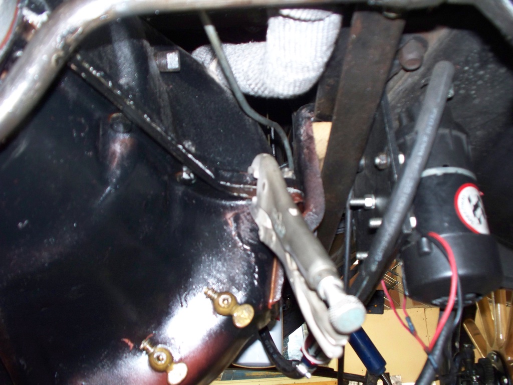

This worked for several years:

Whatever it takes to keep the wheels rolling!

That shows there is more than one way to stop a leak!

Vise grip! not channel lock.

My 89 year ol brain has a glitch every now and then. That is indeed a cheap vise grip. That vacuum trick is great Model T thinking!! I like it!

Oh contrare that looks like a pare of Irwin vise grips best money can buy. My Father inlaw saved a mans life with a pare of those
