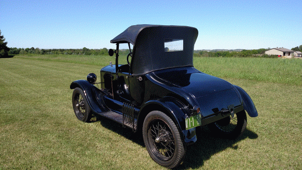

I give up and I could use some advice. My Runabout looks nice from a distance. But if you come closer you will see white wax buildup in certain places that I just cannot get out. My uncle sent the body and frame out to be chemically dipped when he restored the car in the early 1990’s. The substrate was clean and rust-free metal but with many areas with pitting.
The bodywork was smoothed in all visible areas. But, inside door jambs, hinges, running boards and other out of the way places the pitting remained. Those pits are now filled with white wax on a black car. It’s also in all body joints. I have tried many cleaners including:
