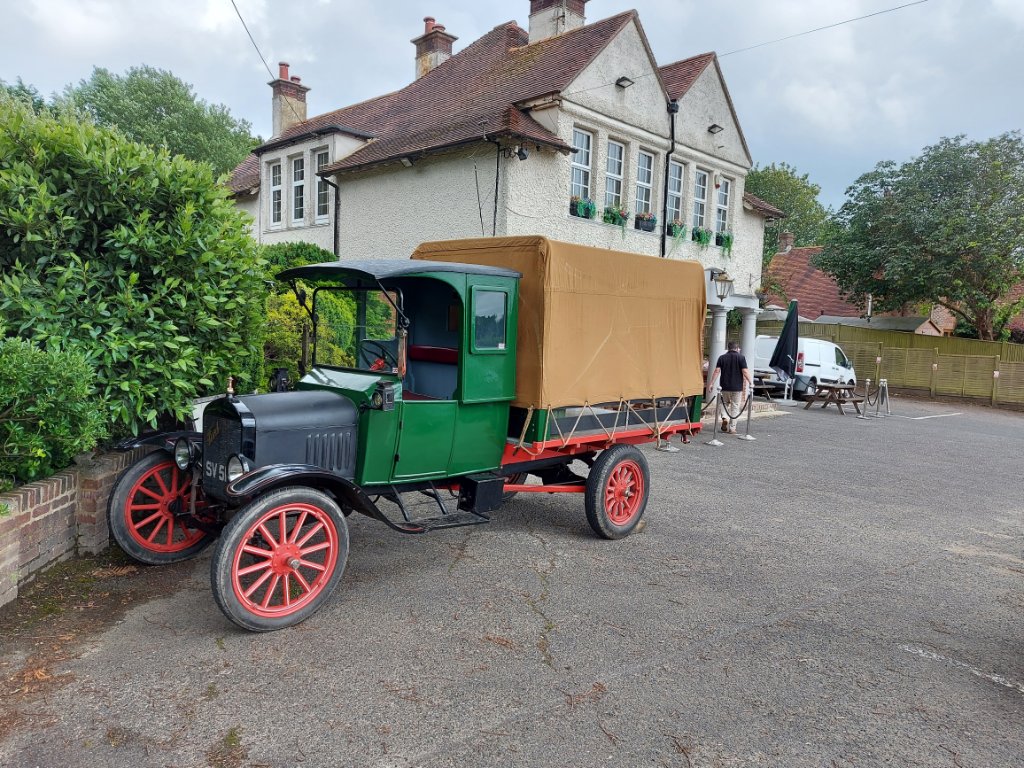

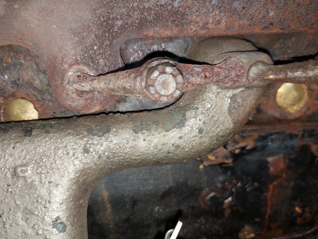

Re: Fitting core plugs, freeze plugs or welch plugs in situ
Core plugs fitted this morning without removing any manifolds. A test run was needed to check for leaks. I thought it best to kill two birds with one stone by driving to the "Local Hostelry" for a pint of Guinness. As you can see there are no puddles on the carpark , success.
Thanks for all the advice, another skill mastered!
