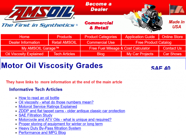

From https://modeltfordfix.com/care-and-feed ... el-t-ford/ By Royce Peterson The original specification for the Model T was "light" oil as oil was only defined as "light" medium" and "heavy".T he guys who collect oil cans know the answer, because there was a period of time in the 1930’s – 1940’s when oil cans were marked with both the old “Light, Medium or Heavy” designations and the current designations. ... So we now know the answer. Light = SAE 20, Medium = SAE 30, Heavy = SAE 40
How often?
Since the Model T has no oil filter in which case non-detergent oil would be period correct. Changing the oil in a T should not be limited to draining but should include removing the inspection cover on the oil dip pan now and then . If you haven't ever done it now's the time. Non-detergent oil causes the contaminants to adhere to inside engine surfaces, so don't be shocked with sludge build up. As Royce points out don't use oil with additives that can be attracted to the magnets in your magneto if you have one. Another consideration is the transmission with its so called "wet clutch", brake and reverse bands. This may lead you to consider Motorcycle oils formulated for that.
In the end seasonal temperatures affect choices as well and multi-grades are always an option. New high performance car engines (My 2 stage snow blower as well) are calling for 0W30. 0 weight is for quick lubrication and easy starting in all weather conditions. Cost and oil change frequency should drive your choice amongst brands and between synthetic and refined/re-refined oil.
So weigh member choices, your location and driving habits, oil parameters and your budget

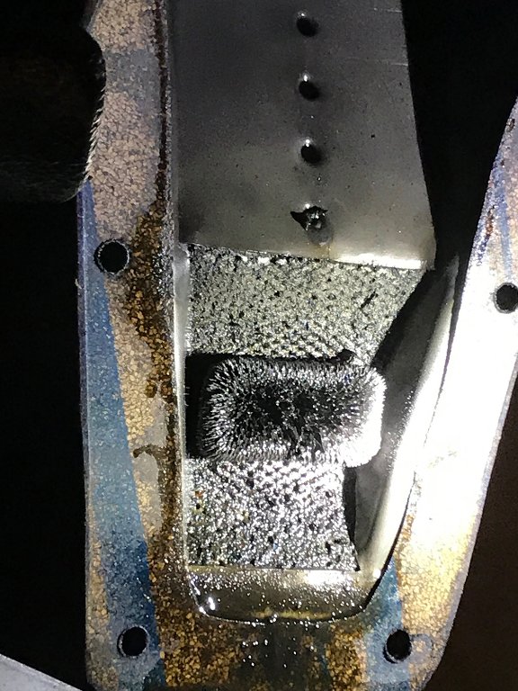

You might want to consider a transmission oil screen. It has a magnet to catch ferrous particles and a screen for larger crud such as band fibers. Clean it every few hundred miles. More frequently on a new rebuild.
This photo shows one where they waited too long to clean it.

Zinc is a conductor of electricity but is not magnetic.
If there is something stuck to the magnets, it is engine wear.
No where above did I ever say that you should or should not use zinc.
If you installed a catalytic convertor then do not use zinc.

More basic information about motor oil by a well respected product manufacturer - could cause some adjust their preferences
https://www.upmpg.com/tech_articles/motoroil_viscosity/

Well I did get to changing all my fluids on my 1915 Touring on the 4th of July and for the oil I went with what I use on all my old cars.....that's Shell Rotella 15w40. The oil in the car was not to bad and still transparent on my aftermarket dip stick but the transmission filter screen an magnet did have some crud in their but that was expected. I ran the car for a few miles and checked the oil and it was as clean as could be. I do not know the history of my car but it has a KC Warford and the fluid looked good but I changed it along with the differential. I also have an electric fuel pump, distributer, alternator, and disk brakes so I think the prior owners used the car and I plan on doing the same. Thanks for all the comments.
Ron
