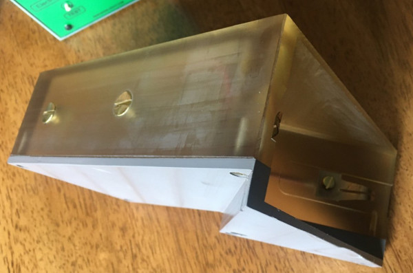

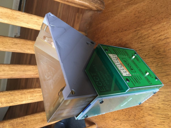

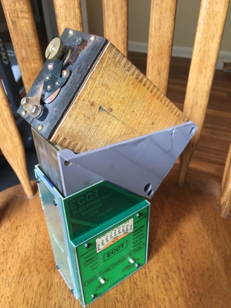

I made an adapter to insert Heinze coils into the ECCT coil tester. I now need help in understanding how to adjust the Heinze coils. [attachment=2] Anyone out there that can help? Don't know if the Kingston coils are physically the same as Heinze.
Keith B
Keith B

Nice work Keith! Mine is a little cruder!
Are your Heinze coils rebuilt ones with later coils inside, are they original, or rebuilt by RV Anderson? There’s a lower ampere setting of I believe 0.8 amps with original or RV’s, as he puts in windings that are the same as originals. The points also need a break in period from what RV had mentioned a while back on the forum but I don’t know that time frame. I do know it took a while for the points to settle in. I would check mine every time I took the car out over an 8 week span. I rarely check them now.

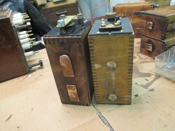

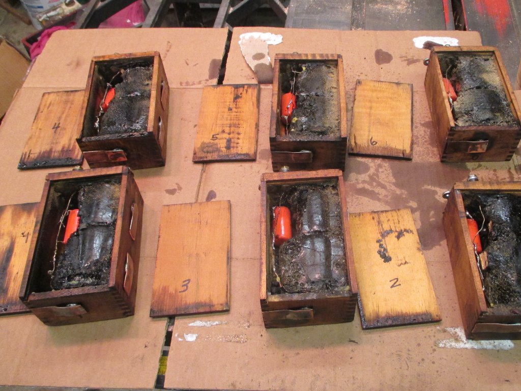

I like driving a lot and like things to be as original as possible, so I needed to figure out what I was going to do to have a consistently good running car.
I looked an the reproduction Heinze coilboxes that fit 1914-1927 KW coils, but was not overly enthusiastic.

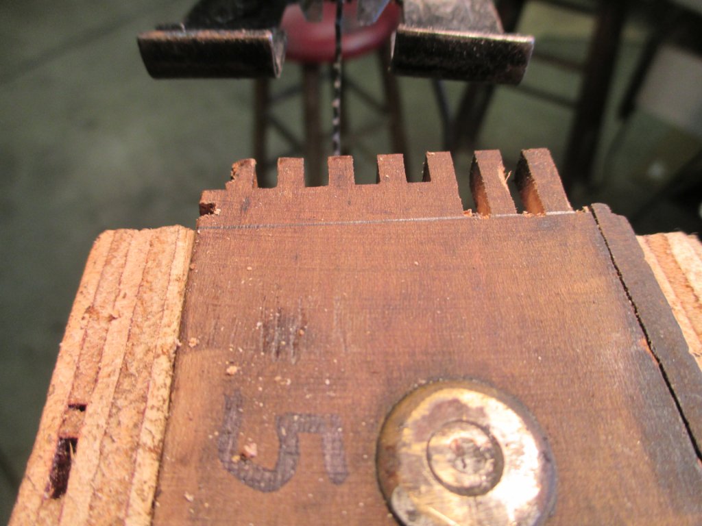

So I rebuilt a set of KW type coils and rebuilt the boxes to fit into the original Heinze coilbox.
I had to modify the contacts on each coil so they have secure connection in the Heinze coilbox.

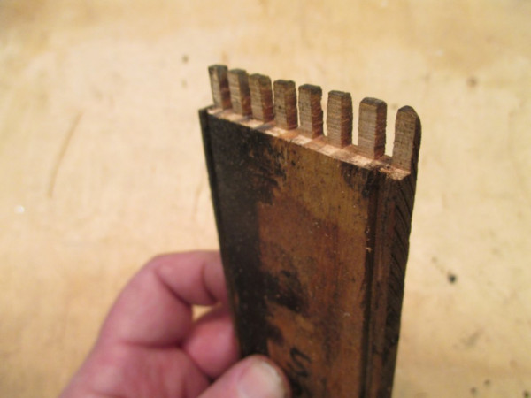

Here are some pics of what I did:
The front to back dimension had to be reduced by about 1/4" so I ended up removing the glass insulator so the new capacitor would fit.
With a couple of side to side shims they fit into the Heinze coilbox perfectly.
And if I want to, I can slide them out and put the original coils in place.

Keith, nice Heinze coil adaptor. Having solved the ability to accurately measure Heinze coil firing time and consistency, the next task as you point out is; how to adjust the point element spring tensions and point gap to achieve equal and consistent firing time. That will take experimentation to understand the relationship of each variable. This is uncharted territory since it has always been done by using the average coil current as an indirect approximation for firing time. I don't own any Heinze coils so don't have much experience with adjusting them.
