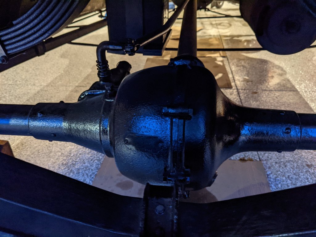

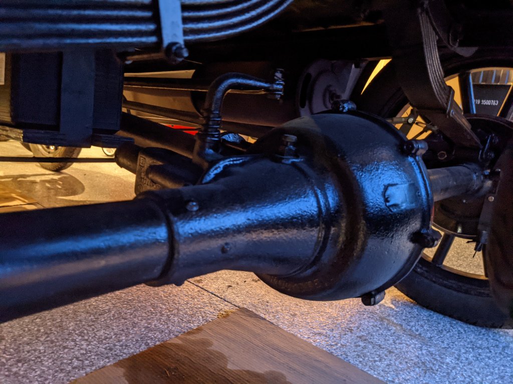

Post by JBog » Wed Jul 28, 2021 10:18 am
Is this the style of ruckstell that you fill up to the hole?

Around the bottom of the housing where the two halves come together.

Some body lifted the rear end in the center. Thats a no no. Makes em a leaker.

Or it was put together without sealer or gasket.
