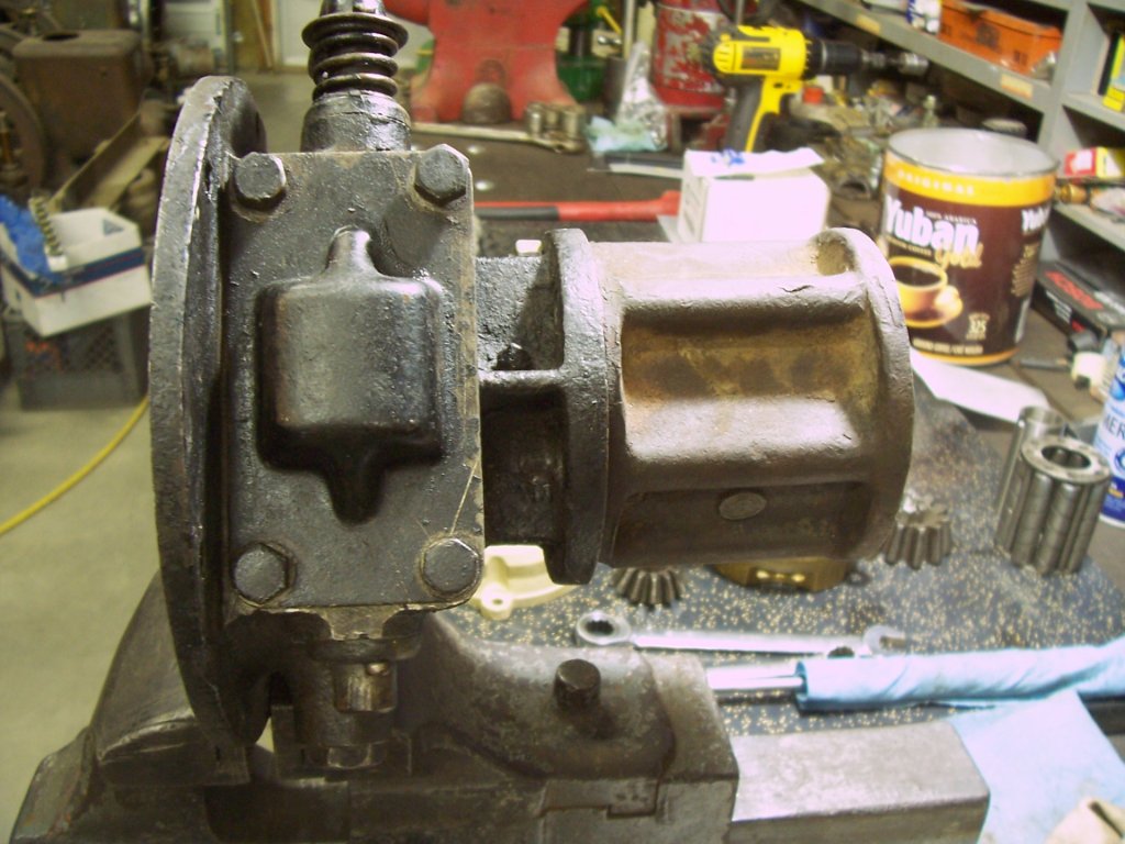

Have any of you heard of a “Jumbo” brand two-speed rear end? Here is a photograph, the best I could find, of one on a 1910 model T Ford. I would be interested in whether they work similar to a Ruckstell, whether or not they are problematic, and any other information about them.
Thank you in advance for guidance you might give me on this question.

need a better picture- looks like it may be a driveline trans of some sort, but...…………….

Just a quick clarification. The photo offered may be of a "1910" car, maybe a wannabe 1910? But the rear end appears to be later 1910s. The Planator underdrives (either Starr or Jumbo) are a 1920s era accessory.

It might work fine, but since it has a modification of the driveshaft and driveshaft tube, and is not as common as the Ruckstell, I would recommend the owner keep a stock rear end complete with the driveshaft just in case the Planator breaks down, they can still use the car with a simple transfer of the rear axle assembly.

Planators, I think that's what you have there, can get into a neutral condition. You will want outside auxiliary brakes if you run one. I think they have a 50% reduction.

The Jumbo planatar can’t get into neutral unless there is something seriously broken. They fixed flaws from the earlier Starr Planatar design to take care of that. If either one’s inside condition is unknown, it is always smart to have another source of brakes.
