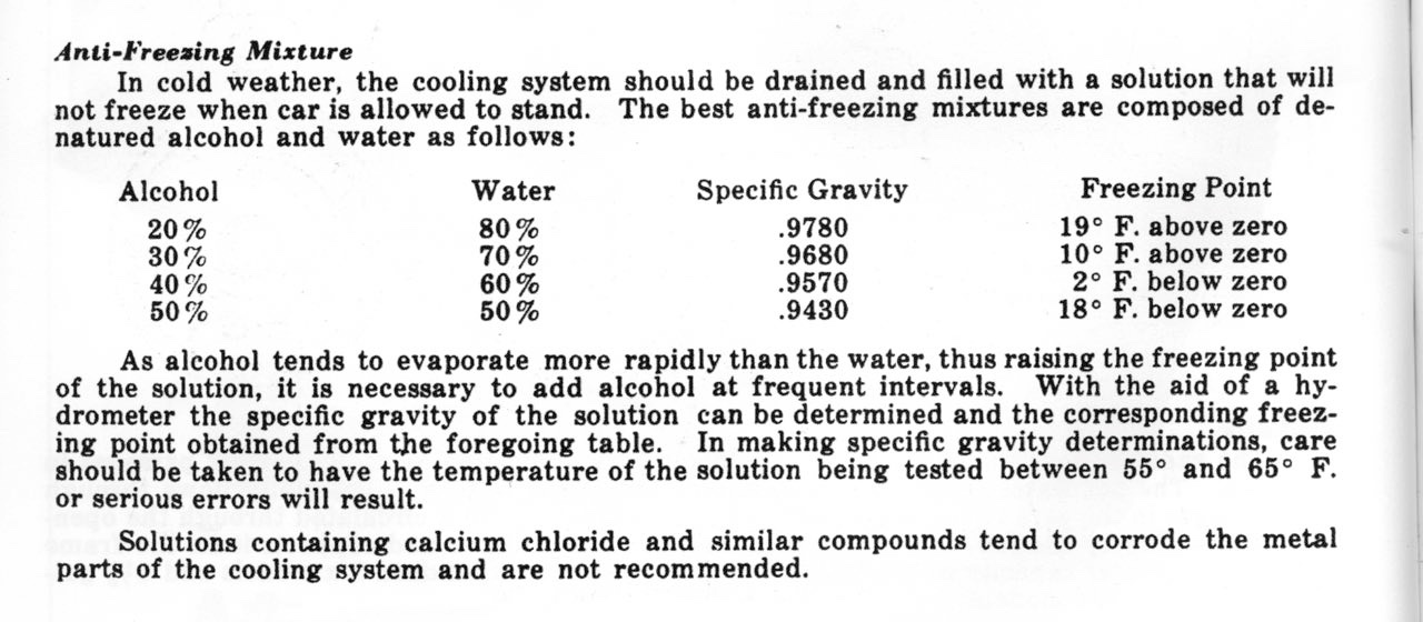

Do you know what proof the wood alcohol was?
Wood alcohol was widely used also.
[/quote]

Here you go Tom.
