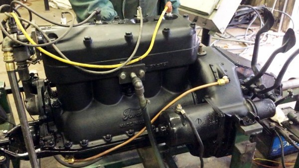

The model T is a whole different beast compared to modern engines inasmuch as it primarily distributes oil by splashing, not pumps and pressure. In aircraft engines (which I am more familiar with) the engine will keep circulating oil as long as the pickup tube is submerged in oil.... in an aircraft with a two gallon oil sump you can still maintain oil pressure down to a couple of quarts...what will be more noticeable will be a rise in temperature as there is less oil circulating to cool the engine. Not so in the model T. While it may be forgiving to some degree, letting the oil drop too much would result in less effective lubrication in my opinion. Frequent level checks and a couple of quarts under the seat is a must!
I'm sure you're also aware of the problem with the front main bearing being deprived of oil when a car is driven on a long uphill slope. That is why many cars have an aftermarket oil line installed to catch oil by the flywheel and deliver it to the front (see photo.) There is also the problem with under seat fuel tanks where too little fuel on a steep uphill slope can starve the engine of fuel...solution there is add fuel or go up the hill backwards.
