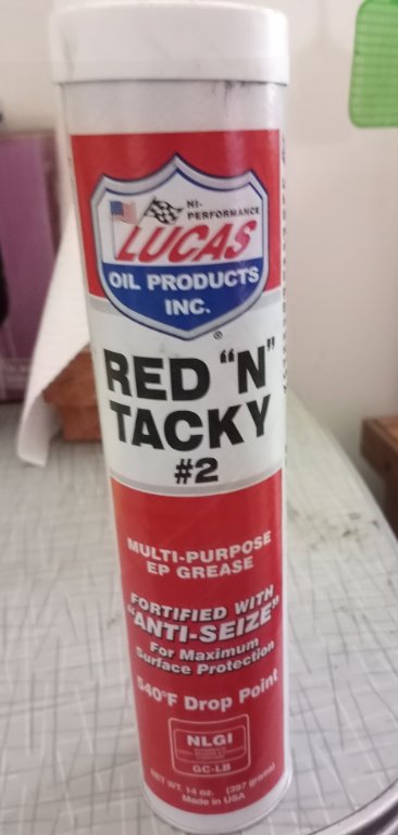

Did a little research about NLGI numbers. Also it would seam that CV joints are similar to T's ball cap & u-joint design so why not that type of grease?
The NLGI consistency number, sometimes referred to as NLGI grade, refers to the relative hardness of a grease used for lubrication as specified by the institute's standards. https://petroleumservicecompany.com/greases/
NLGI 0 grade grease is a very soft grease about the consistency of brown mustard.
NLGI 00 grade grease has a semi-fluid consistency similar to applesauce.
NLGI 000 grade grease has a semi-fluid consistency similar to cooking oil.
NLGI 1 grade grease has a semi-fluid consistency similar to tomato paste.
NLGI 2 grade grease has a consistency similar to peanut butter.
Interesting comments from https://smazka.ru/eng/news/novosti-komp ... lya-shrus/
STABILITY - squeeze small quantity of grease on sheet of paper. If there is no any oily spot on paper around grease within one minute, grease is quite stable.
BODY - Good grease for cv-joints should have 2/3 NLGI consistency number.
ADHESION - In simple words, adhesion is stickiness. Squeeze small quantity of grease on the surface and press down with your finger. It should stretch like bubble gum. It will guarantee that the grease will not leak from cv-joint and will not be washed out from the unit by water even if the axle boot is broken
So sounds like NLGI 00 is too thin and will leak around the ball cap, requiring more refills. I like the ADHESION explanation NLGI 2 sounds appropriate
