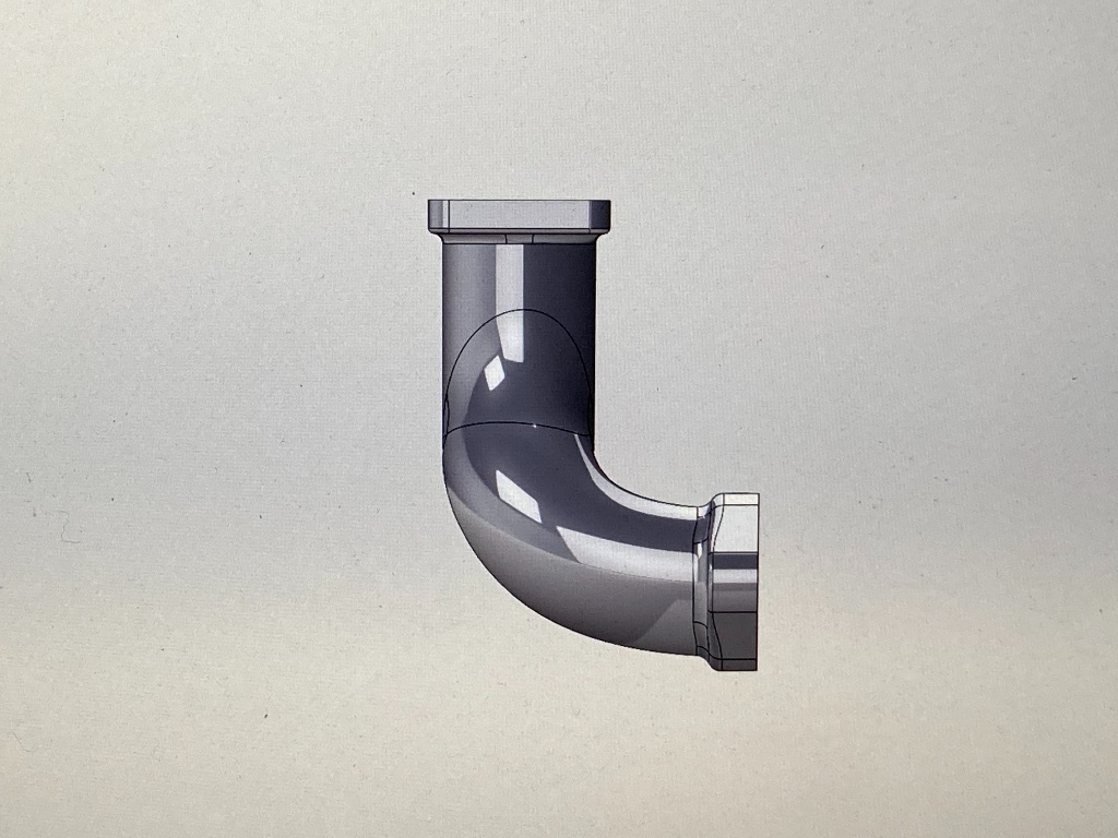

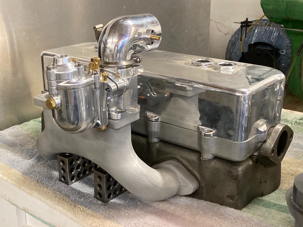

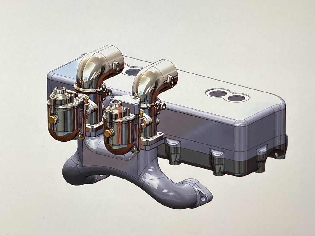

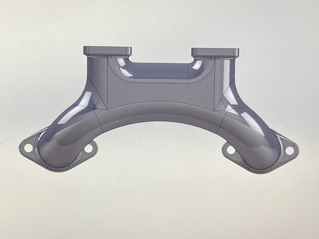

It’s time for me to consider the intake manifold for my Akron-Hed project... I’ve considered almost every currently available manifold as a donor to be cut up and modified, and nothing seems to align with the look that I want.
I am going to run 2 of my new Winfield S-B downdrafts... and want to run a plenum style intake manifold. I really like the shape and look of the Winfield manifolds for the Model A’s... but would be a ton of work to narrow to fit the Akron-Hed, change the mounting flanges, cap the single carb flange, and add 2 B inlet flanges. So I began to design what I want. I considered machining it in pieces and welding together, but have had issues with broken welds on aluminum manifolds before. Time to consider casting. I found a relatively local foundry that will 3D print sand instead of building a pattern for a one off part.
I know there are only a few of these Akron-Hed’s out there... but if you are interested in one of these intake manifolds... now is your chance. These may fit other make overheads, but I make no claim as to fitment. Manifold will have 1.500” diameter runners, 9.438” centerline between ports, 2.750” bolt spacing on port flanges, and Winfield S-B carb flanges 5.000” apart. Minor changes to the design could also be made to accommodate other head configurations...

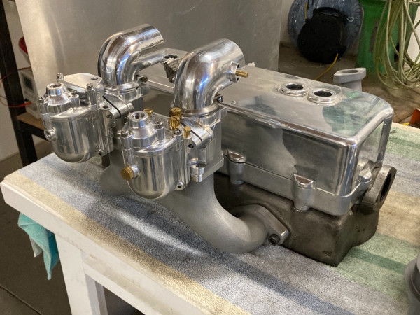

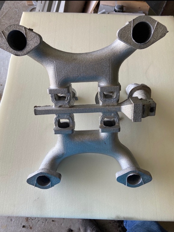

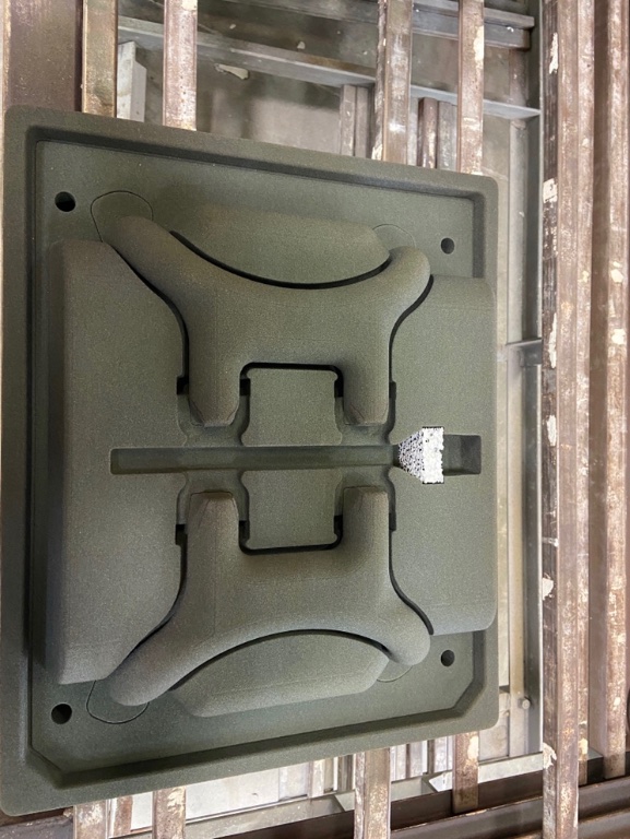

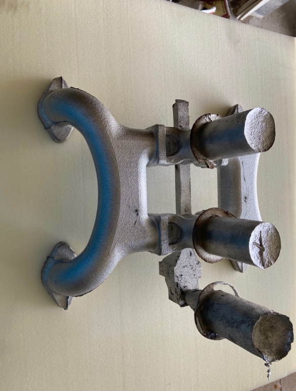

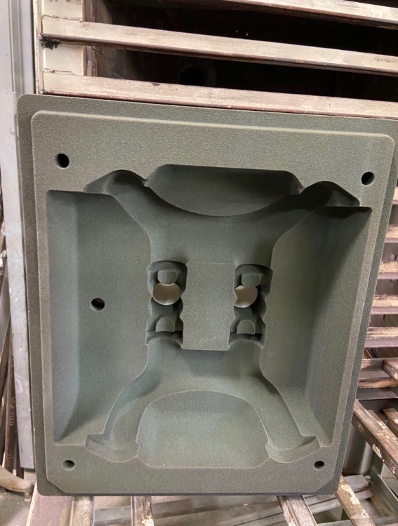

A little sand... a bit of strategically placed glue... and taaaa daaaaa! An intake manifold! Some machine work required...
Posts: 6800
Re: Speedster intake manifold
Post by Scott_Conger » Mon Sep 20, 2021 10:59 am
Well, how cool is that?

VERY IMPRESSIVE!
I’ve done some casting where I 3d print the object in PLA and then “investment cast” using the traditional materials and then burn out and fuse the ceramic and then pour the metal and then break the ceramic. Both ways work.
All the best!

Just what the heck can't you make, Kevin ?????

The port spacing is the same as the flat head, and I hear most overheads are the same too. I will have an extra manifold laying around... that is unless I botch the machine work😉

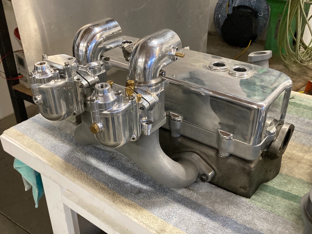

Kevin Pharis
Posts: 1656
First Name: Kevin
Last Name: Pharis
Location: Sacramento CA
Post by Kevin Pharis » Thu Sep 23, 2021 4:32 pm
YEAH BABY!!!
Southfork Creek
Posts: 185
Joined: Wed Jan 09, 2019 9:13 am
Last Name: Wightman
Location: Phoenix AZ
Post by Southfork Creek » Thu Sep 23, 2021 8:01 pm
Beauty! A symphony of polished castings!!
I don’t intend to mislead anybody... but the only castings in this pic is the iron cylinder head and the intake manifold. None of which are polished... yet!😉. All the rest is machined from solid bar. Details here for those who haven’t seen my carburetor or Akron-Hed posts;

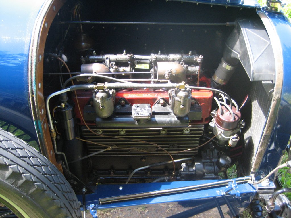

1938 Riley over head V-8, 4 Winfield carbs all facing the “wrong” way. This photo is from Speedy Bill’s museum, so it probably never ran this way. But Kevin’s flooding theory sounds about right.

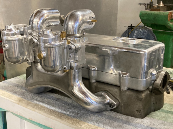

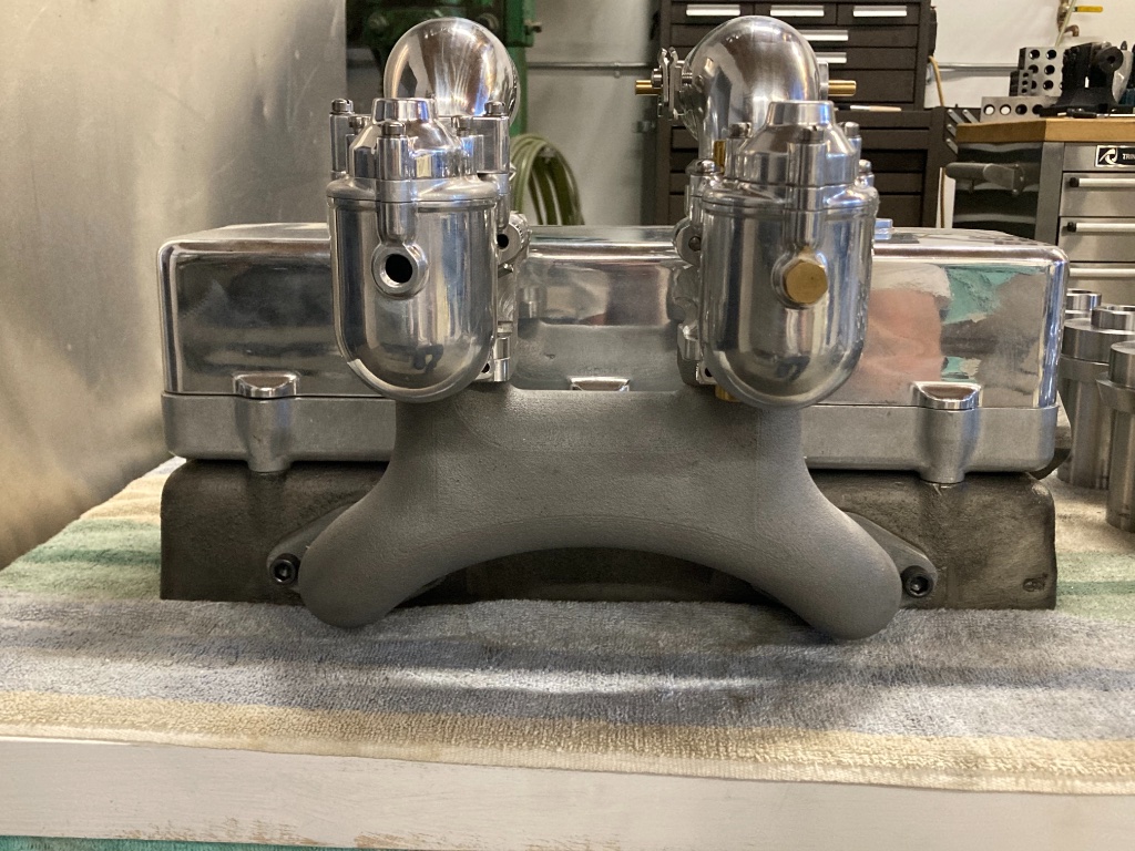

Post by Kevin Pharis » Sun Sep 26, 2021 12:34 pm
Look y’all... no clamps!
Gonna look real nice all polished up!😁

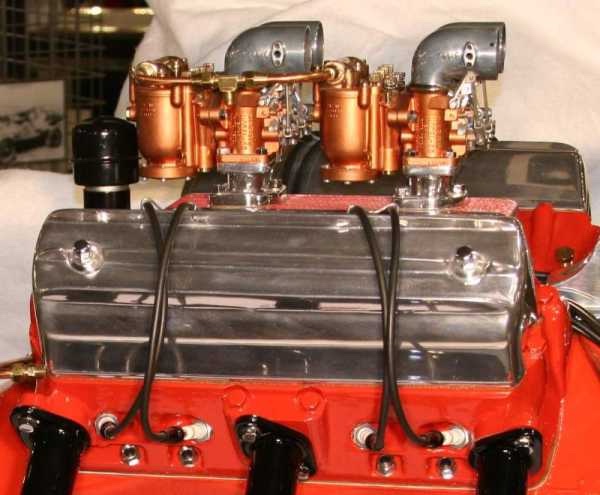

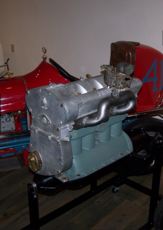

Came across this backwards Winfield pic from Speedy Bills Museum today and thought bout you Andy...
Turns out the new manifold does look nice all polished up...

So...…. regarding float bowl orientation, I thought I would browse thru my Winfield Carburetor manual for any bowl orientation information. The manual covers installing carbs on pretty much every automobile made from 1925-1931. I found two instances where the float bowl was to be installed to the rear- 1) Model T Fords and 2) '24-'27 Oldsmobile. All others clearly stated the float bowl was to be installed to the front. So, draw your own conclusions from that.
AndyClary
Posts: 909
First Name: Andrew
Last Name: Clary
Location: Usa
Post by AndyClary » Sat Oct 09, 2021 1:25 pm
They probably looked at two things with the T application. One-they needed to clear the generator. Two-they probably drove a Model T and figured it wouldn’t brake hard enough to slosh any fuel.
Andy

You clearly read better than I do Dan, I looked thru my catalog for some time a while back and couldn’t find anything regarding bowl orientation. One would think that if the bowl HAD to be facing front, there would be a warning on every page...?! Thanks for the info Dan, I’m dedicated now anyway... but it’s reassuring

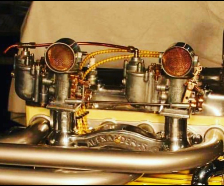

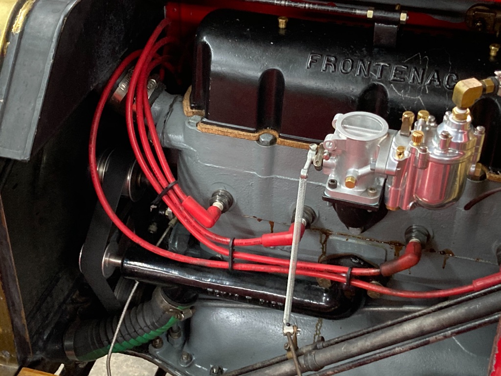

Maybe I’m just trying to convince myself that sideways carbs are goin to be OK...
And this one just posted by Hank Lee in the classifieds. Maybe he can give us some insight as to how the carbs ran on this shiny chebby. These carbs are certainly far enough apart to mount with the bowls facing forward

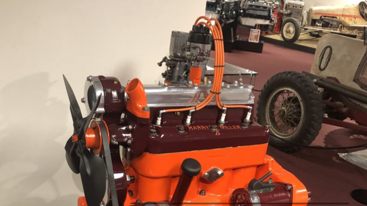

Adding to my collection of “wrong” mounted Winfields...

Post by Kevin Pharis » Sun Dec 26, 2021 12:01 am
With all the excitement of firing off my new carb for the first time... I completely glazed over the fact that my dad had mounted his carb “backwards” when he put the Fronty in a while ago

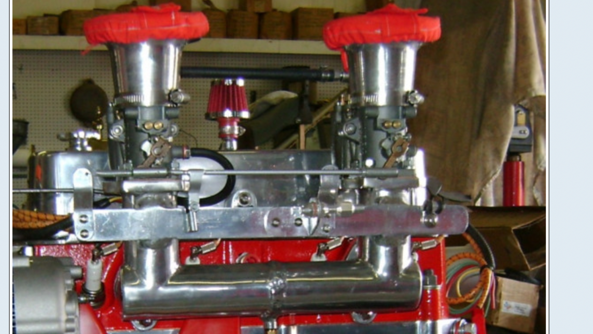

Post by Kevin Pharis » Wed Apr 12, 2023 5:05 pm
It’s been a while but found another sideways Winfield installation over on the HAMB
