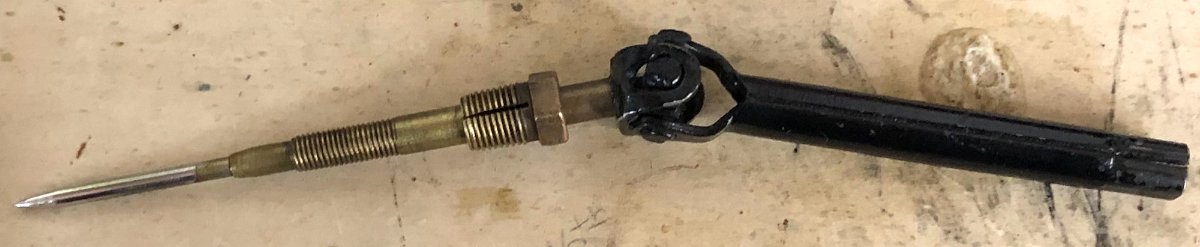

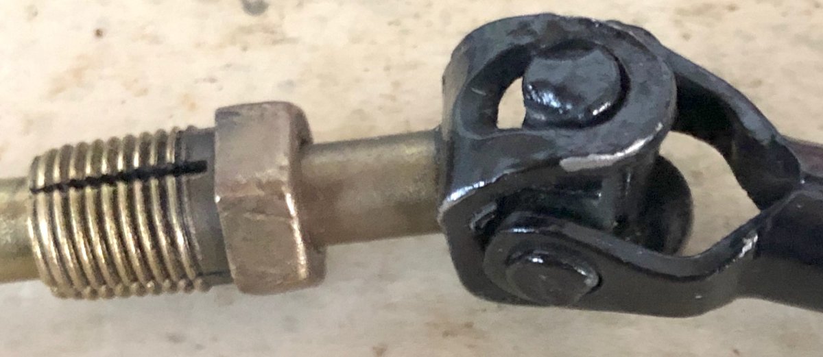

Thanks Dan, I may do that. I'm not sure what I have now. It looks & feels good & solid although dry. No one, including me, has given it any lube in a long time. I didn't consider it a moving part. I just twiddle it before cold starts a tiny amount and then set it back once the motor gets up to temp.
Can you tell if this is a pot metal terror or a reliable steel assembly?

What you got there is a pre 25 needle with the ears bent up. You may still be ok-Your choke rod pull shaft collar has a set screw for adjusting.

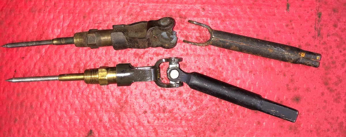

Wow! That part shows some real creativity. I know about the collar that holds the primer rod in place, I'll be taking that off to see what is needed at the next work session.
Is the U-joint steel or pot metal? I might as well get the good stuff if I'm going to need it.

The repo u- joints are cast from a type of ferrous metal, magnet sticks slightly. Last new one was coated with black paint and was sticky to work, removed the paint and the u-joint worked better.

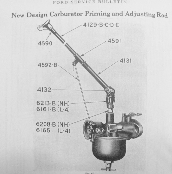

If you are replacing that 'garage built' combo needle, with the new set from Lang's shown in my prior post (6213B)......you will also need the later lock or clamp nut. It has the tall cylinder that the upper split collar fits upon. You tighten the split collar just a bit to get resistance when you adjust the needle. Otherwise without a good resistance, the needle setting can back out or in and cause rough running down those bumpy roads!
