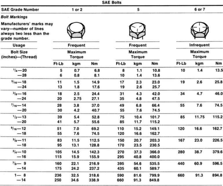

As in Henry's days Torque specs were not a common thing, some of us are in the dark about how much to tighten, say the head bolts.
As a general guideline you can use the specs given in this chart, BUT... use with care on our old machines and old fasteners.
At least it gives you a ballpark value, but proceed with care, inspect threads and holes well, be sure to clean out debris and lightly coat fasteners with oil or another appropriate lubricant.
Then start with tightening with half or two thirds the value specified and carefully work your way up.
Oh and allway, ALLWAYS try the torque wrench first in the vice, you would not be the first to dicover it is not 'clicking' while you strip the threads (don't ask)
you may print this and hang it on the shop wall
