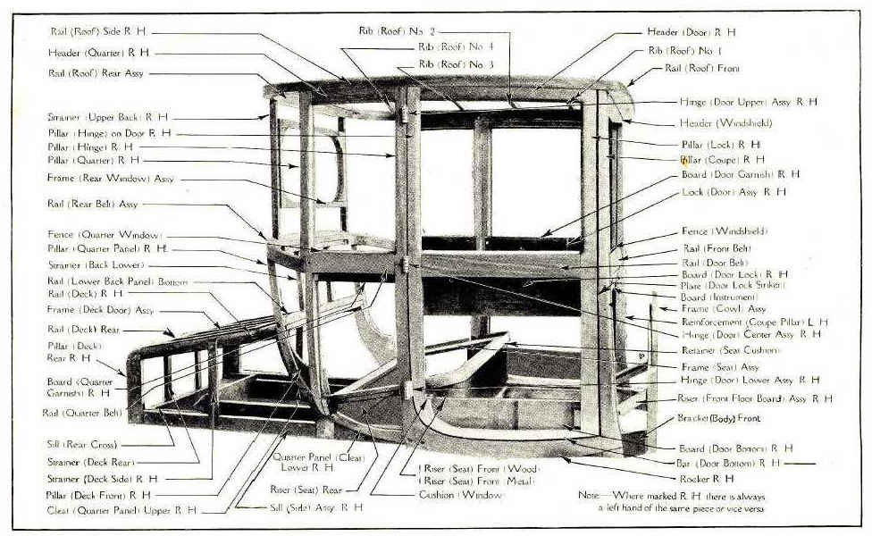

- Posts: 4386
Re: Non-Electric Model T Coupe Dash and window trim
The picture George D shows are of a starter/generator 'electric' model T. The wooden framework picture Is clearly of a common pillared coupe. There was a very short time in late 1918, and early 1919 model year T coupes that the starters and generators were not yet ready for the production line. Those few (thousand?) coupes would be 'non-electric' models, in the later (1919 to 1923) style. Otherwise, all non-pillarless coupes were 'electric' models.
Is yours a pillarless coupe? Or a very early pillared coupe?

It has a fixed pillar between the door and quarter window.
