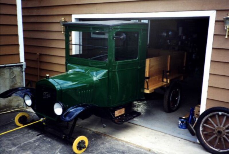

We only did this once!

Post by Mark Gregush » Thu Aug 05, 2021 12:13 pm
Maybe someone will pop up the pictures, but I have seen photos of guys that cut disks out of plywood and mount to wood wheel hubs to move cars around. Of course, with the price of plywood, might be cheaper to have wheels re-spoked! LOL If I were doing that, I would go with thicker plywood and maybe a couple of layers thick, and could be smaller diameter, but maybe bigger then those shown above.
