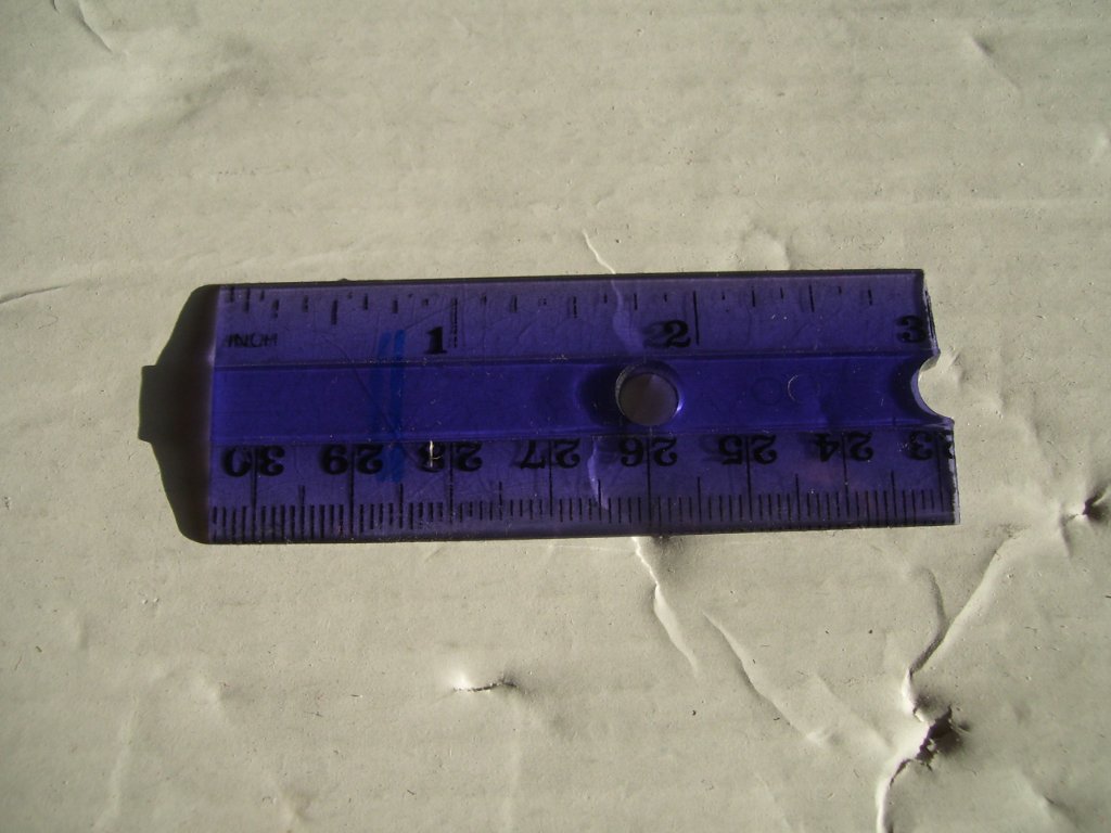

The roller (Vane Actuator Assembly) is installed first. To measure and make sure it was installed correctly I borrowed a plastic ruler from my kids.
I cut it so I had a 3 inch ruler. I wonder if they will want it back. The vane actuator fit well, so now to the timer. It fit well, also. That was expected.
