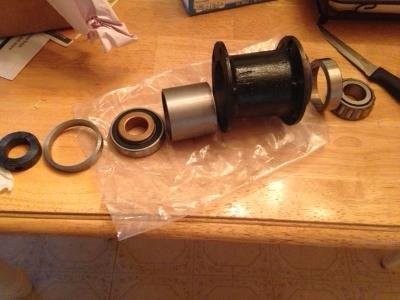

Thank you so much. I was measuring the two and I thought it would work. I am a machinist so I make my own modern bearing spools. I could alter my dimensions a little bit to make it work if I had to.

If you have any junk axle housings the tube works good for the spacers.
Craig.
