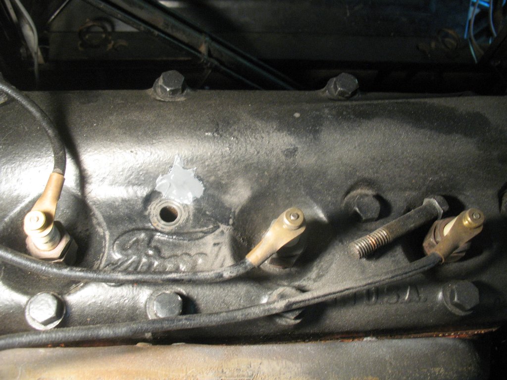

A few years ago this head developed a tiny coolant leak near the M in MADE. I patched it up and had many trouble free miles.

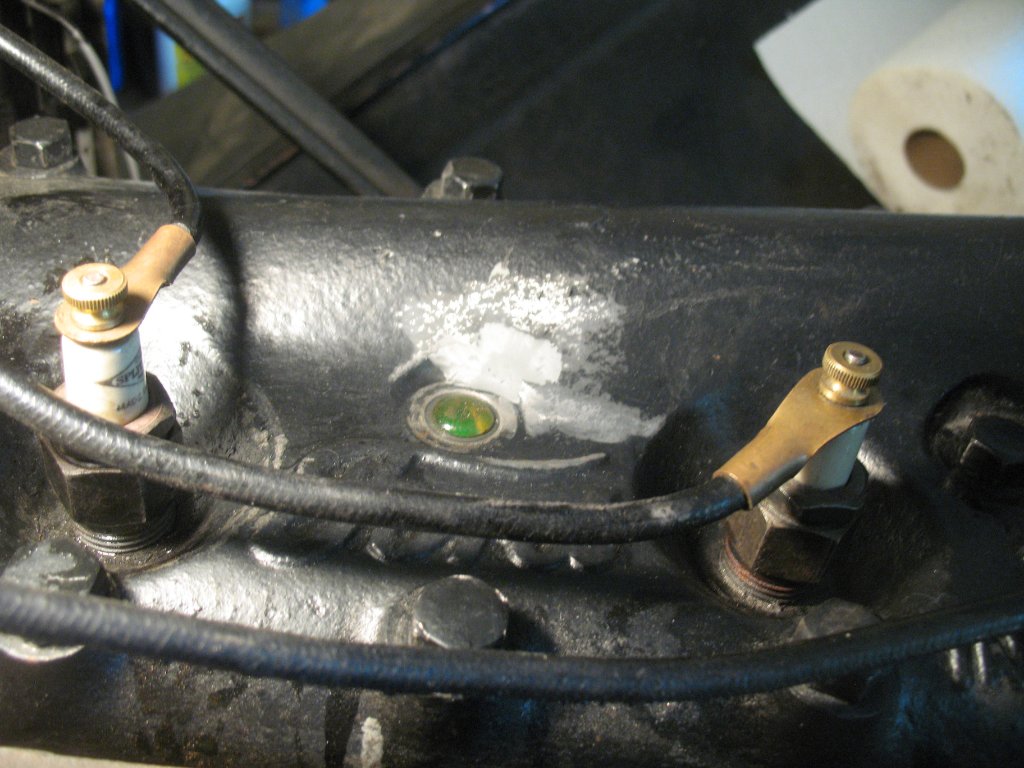

But recently another tiny leak appeared just to the left of the #1 bolt. So yesterday I ground out the little crack and filled it with JB weld.
This afternoon I smoothed the patch and started filling the cooling system to see if I had plugged the leak. Well, I had. The little leak was gone. But a bigger leak quickly welled up in the bolt hole. Looks like I'm in the market for a better head.

That seems like an odd pattern of failure. Is the head badly corroded on the inside of the water jacket?
Three different leaks would seem to suggest so. I wasn't in the market very long. After posting I phoned Model T Haven, and within ten minutes I had a replacement head lined up. I'll pick it from Mark at the club meeting Thursday night. I should be back on the road by this weekend.

Returning to the subject, That head has either corroded out from rust, or more likely has been frozen with the ice expanding causing the crack. One other possible cause would be pouring cold water into an overheated engine. If the coolant level in the engine was very low the cold water would suddenly contract the hot head causing it to crack. Anyway, used heads are easy to find, and new ones are available as well.
