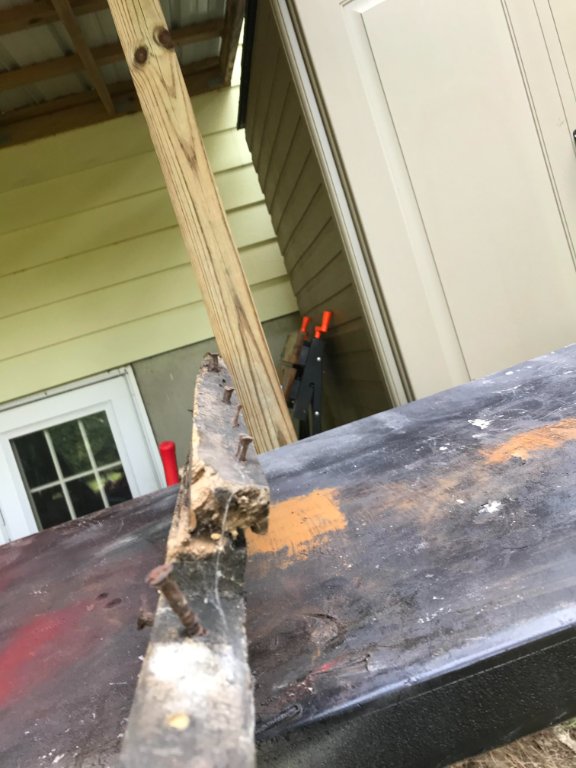

Scott,
Here's part of my original Sills on my Centerdoor. If you look just beyond the screw, you can see the joinery used to put the wood pieces together.

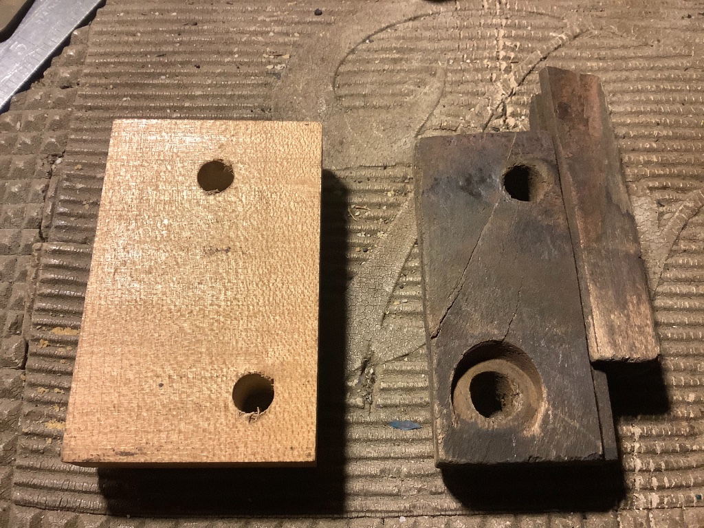

Here is a small ford wood part with the linderman joint. You can see why they haven’t been seen much from this specimen. My speculation that wood boards were made from scrap, and machined into smaller parts. Too small for this operation , it was charcoal time, baby. Note the angled, counterbore hole on the original jointed hood block. Two different hole diameters, also.

My 1926 Franklin 11-A Rumbleseat Coupe has Linderman machine joints all over it.
I am lucky enough to have most of the blueprints for the car as I have worked on it, and many parts are designed to be made from
"Linderman Machine Stock"
You are correct. If it was too small to be put through the Linderman machine, then it either went into the Franklin Factory furnaces, or was sold as scrap. H. H. Franklin had a policy that any scrap material was first offered to employees of the company, and then if there were no buyers, it actually went to the scrapyard. In the Franklin literature, there are many articles from Franklin employees who bought "out of style" leather and upholstery fabric, and did their furniture at home, or upgraded their cars to more stylish trimmings. They sold a lot of paint and trim hardware to employees as well.
