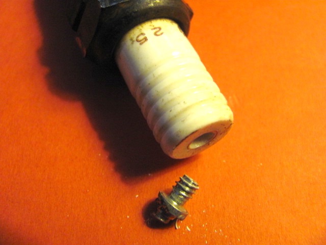

Did note at sometime, someone, used pliers on those tiny thumb nuts. That can cause real issue with the modern Champion 25s that have an alum. terminal. That terminal is just a short one, and ceramic potted to the insulator. Any real pressure on twisting the terminal nut will bust it apart!

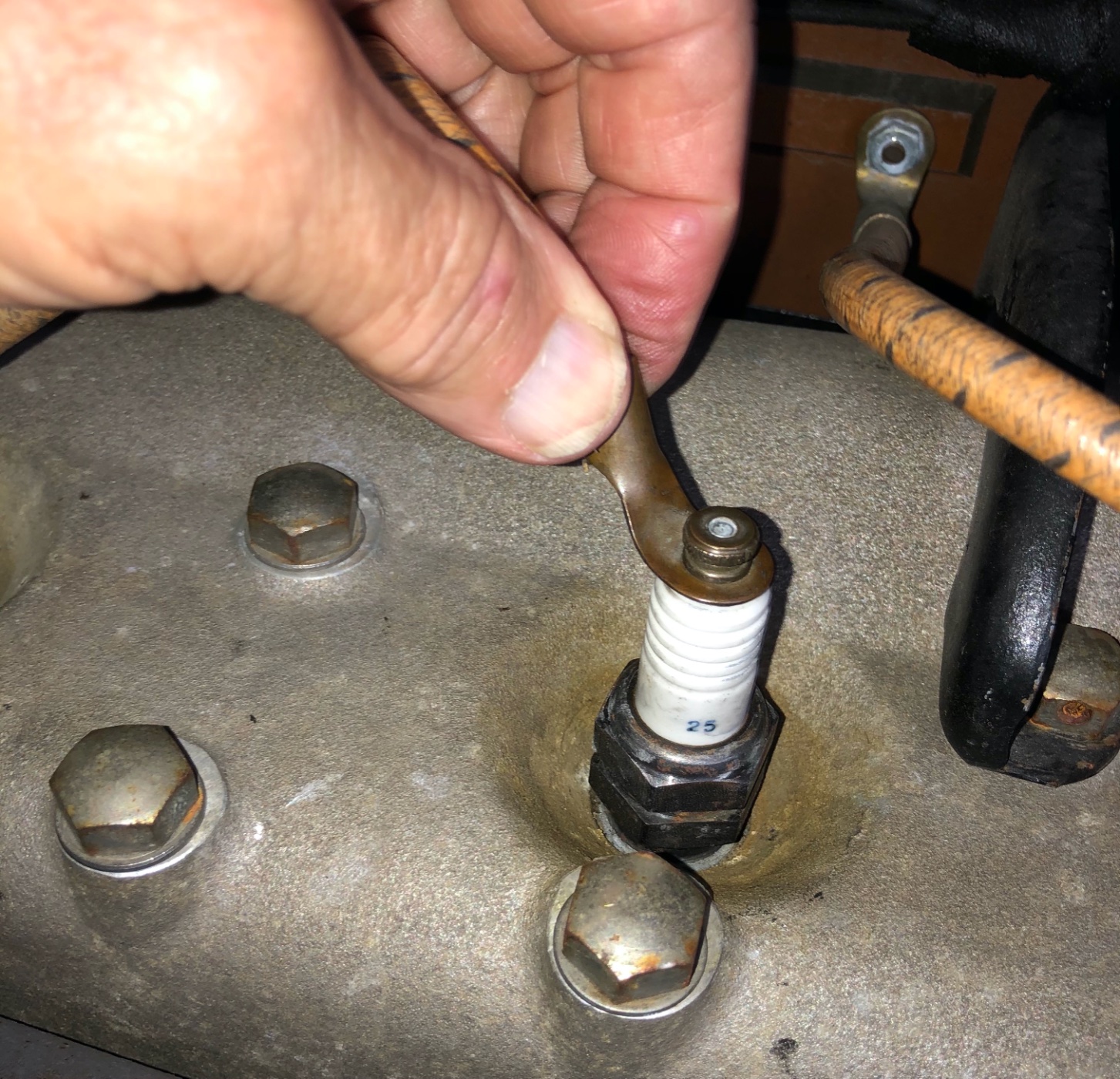

Wire lead pushed clockwise will snug up just fine.

I must admit I did use small pliers on the old ones a couple of times, even on the Champion 25 I used as a spare. Bad move! Thanks for the tip 🙂 my leads sometimes still felt loose doing them by hand 🤔
