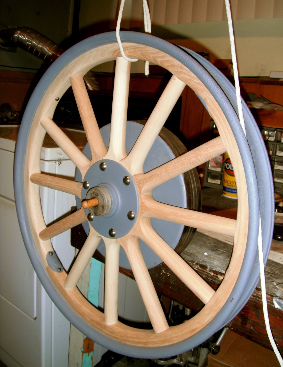

I've used Stutzman's Wheel Shop and can tell you about the services are available there, but not elsewhere. He'll re-wood your entire wheel for about $200. I doubt very much that he'd replace only the tired spokes because it wouldn't pay for him to do that kind of work and the result wouldn't be satisfactory or safe. If you're gonna do it, do it! At Stutzman's, sandblasting and priming your metal hubs and rims is an option for which he charges a very reasonable extra fee. The end product, in any case, is a bare-wood wheel (as in the accompanying photo) requiring either painting or varnishing or whatever other wood finish.
