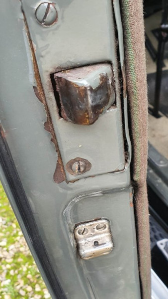

Chris, Where does the bumper with the metal clip go?

Re: Where Do These Door Bumpers Go?
Sorry, this link didn't appear in my earlier post:
https://www.modeltford.com/pl.aspx?t=s& ... per&page=1
It shows various sizes of bumper.
I wasn't clear before. My car has bumpers at the top of each door, near the rear, and in the rear face of each door, near the bottom, about 12" below the latch.
The steel clips are not in the door, but in the body, about 6" below each latch. The rubber bits are hidden. A chromed striker attached to the rear face of the door slides into the spring clip.

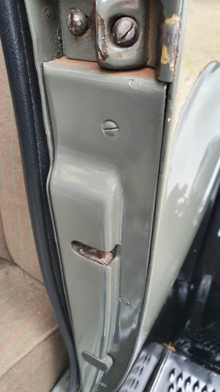

Chris, Are talking about a coupe? A photo of the metal clip installed would be helpful if it is coupe.
