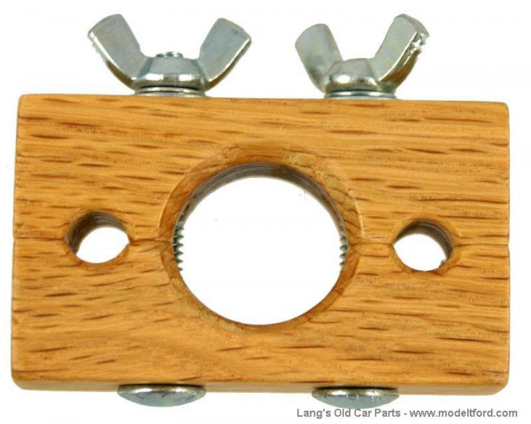

I believe one or more of the vendors sells a device consisting of two wooden blocks which clamp around the steering rod and lever rods below the firewall. The blocks can then be adjusted to give proper friction on the rods and prevent rattles.

In addition to bending the quadrant up like Mike said, the grooves in the quadrant are probably worn almost smooth. You can dress them with a triangular needle file. The springs on the other side of the column mounting plate are probably worn out too, but will require you to partially disassemble your column to do it. The temporary fix for that is the wooden clamp already mentioned.

Your throttle lever may be bent and or worn where it contacts the quadrant, the quadrant may be bent or worn, the spring on the throttle rod may be broken or rusted or somehow damaged, or a combination of the above. What you describe is not normal, and the wood block recommended by some may be a good bandaid fix but is not the final solution.
